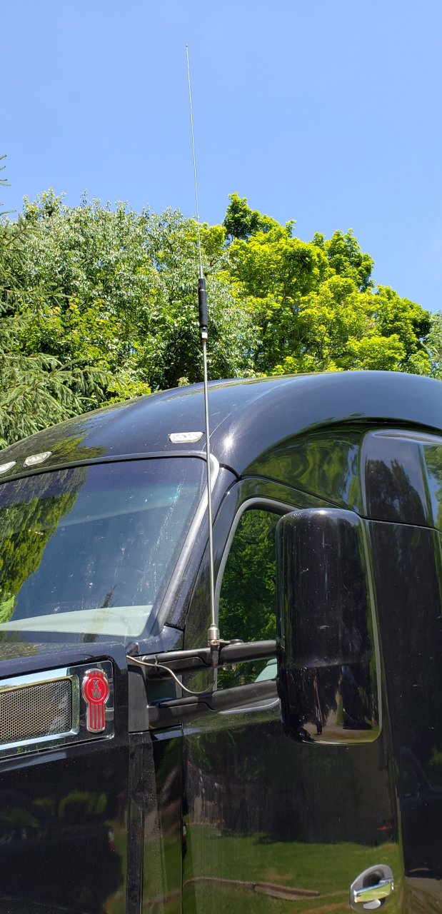

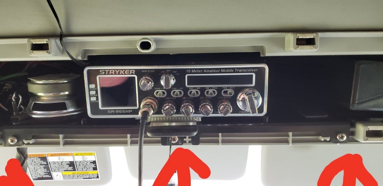

    Latest T680 solution.

    Is that one of your homemade creations or is it mass produced by a company and for sale to us desperate Truck Drivers, looks like a definite improvement over stock, because me personally would like to only run one anrenna.

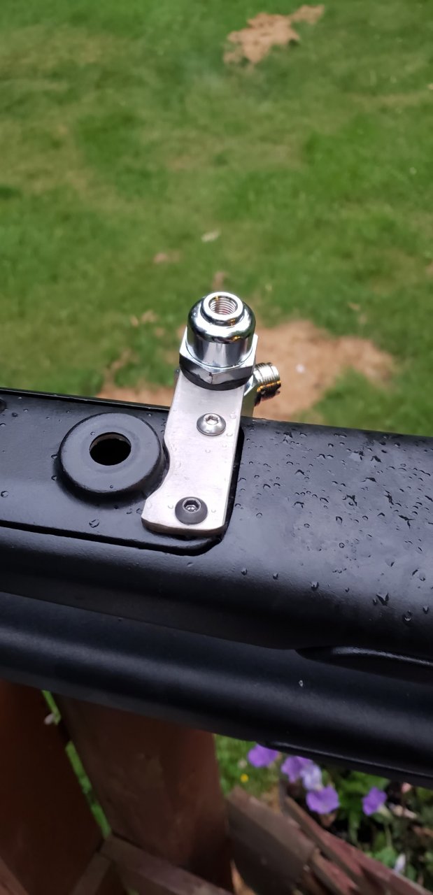

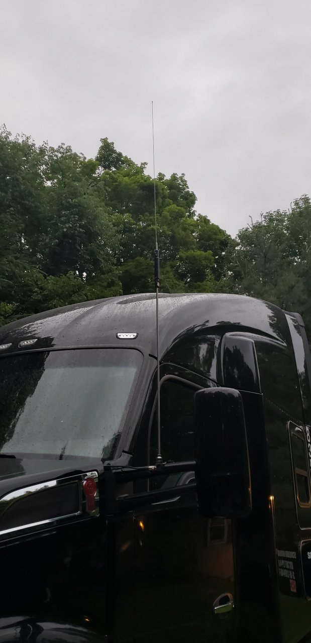

    It's a copy of one of my Homemade Creations. Here's a daytime picture. The guy ended up making a bracket 5/16" thick because the 3/16" bracket had too much Flex.

    There's a small tray that slide into the trim opening. Remove the tray and then the trim around the radio Just pops out. Then take out those 3 screws and slide that whole tray out. Look under it and you will find 4 screws that hold the rails the radio tray slides on. Remove those and the rails. Then a big radio can fit in the hole.
