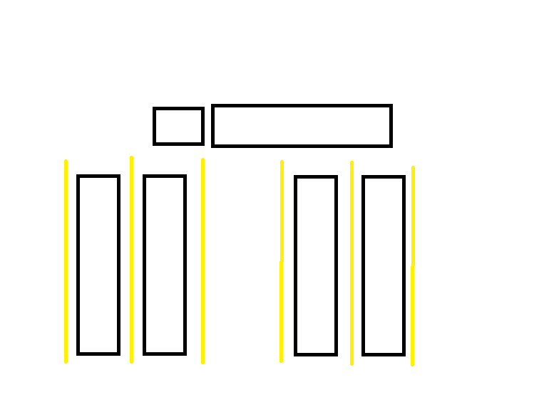

    Get nice and close to the row of trailers/trucks you'll be backing into. Stop when you get your cab side extenders even with the line that will be on your driver's side when you've finished the back. Crank the wheel all the way right. Pull up until the tractor has made nearly a 90 degree right turn (depends on the available space). Stop. Crank the wheel all the way left. Pull up until you've made a 90 degree left hand turn. Straighten the steering wheel. The tractor should be parallel to where it was when you snuggled up next to the backing row, and the trailer should be at about a 45 degree angle to the hole.
    Now just back it up and follow it in.
    I'll go draw a picture.
    Clearly, this is an ideal situation, but once you learn this pattern, it can be tailored to most situations. Adjust as necessary for the wheel cut of the tractor and the distance from kingpin to trailer tandems, and for the available pull up space.
    Always, the best option is a straight back if you've got the space.

    That is definitely the IDEAL situation which happens much less often than you'd hope. The main problem you're going to have is obstacles in the way of the TRACTOR while driving the trailer in the hole. You must always compensate for this. In many truck stops and shippers, the row on top is going to be much closer than in the drawings.
    Experience will teach you how to get in these holes and frankly, one day, you'll be so tired and the only hole available will be the tight hole and you'll get er in there by God, though it may take a while.
