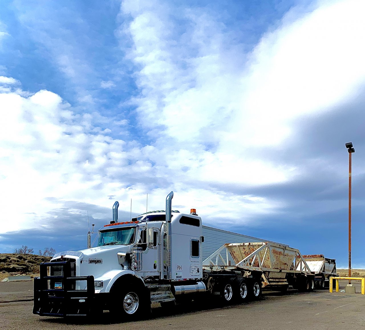

  6. bonder45
    bonder45 Road Train Member
    1,803
    5,452
    Oct 2, 2011
    Williston, ND
    So far backing has been quite a failure.
    I enjoy the drive through parking here I have at this truck stop. lol
    Still choked at my boss for buying these POS trailers but also grateful he bought trailers so I can actually work while the oilfield is down.
    Honestly I’m unsure, we shall find out when I get my first load.

  7. Caterpillar Cowboy
    Caterpillar Cowboy Heavy Load Member
    837
    608
    Nov 11, 2010
    Wyoming
    Looks like a Ranco set? Fix what's messed up on them and give em a dupont overhaul and you'll like them. Ranco's at the top of my list for belly dumps.
