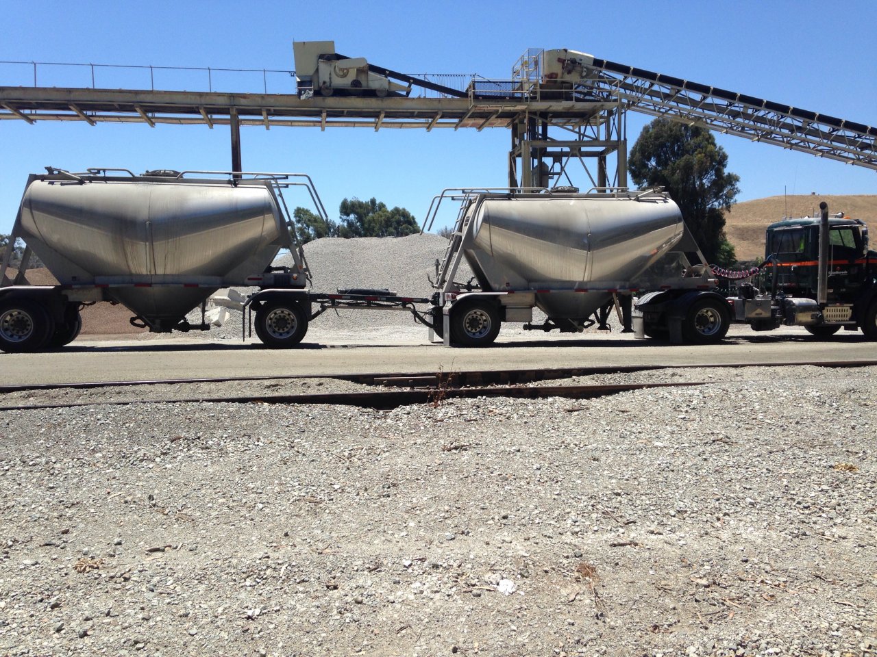

    I wanna say it may be. It's not a dolly like the freight doubles. It's a pull trailer connected to the first trailer on a fifth wheel. It's probably about ten feet id say. I can back them straight about ten feet. I was trying to steer the rear trailer like a pull trailer on a truck and trailer but obviously the first trailer got wacky

    Backing any combination is about steering the congear/dolly. Beau that is a B train.

    So this is a b train?

    Nope that's a set of double pneumatic dry bulk tanks with a turntable con gear. Drove the same set up for a few years w/ 8 axles. You can back those up, carefully.

    Ok cool. Do you steer the rear trailer like a pull trailer?

    What kind of double? I've been doing B-trains (flat) for just over 6 months now and I've finally started to grasp how to properly control them in reverse (at the beginning, there was a lot of pull-up corrections).
    The key to getting them to go backwards in a relatively straight line is to use VERY tiny adjustments on the steering (I'm taking an inch or two at most) and to start counter-steering before the rear trailer (pup) starts going the other way. Also, a good setup is key to getting it done quickly.
    It's really hard to describe without being able to show you in a truck. But I can tell you, once you get a hang of it, they are much more enjoyable to drive.

    With B trains you steer the tri-axle group just like a set when backing. Sets just have one more pivot.
