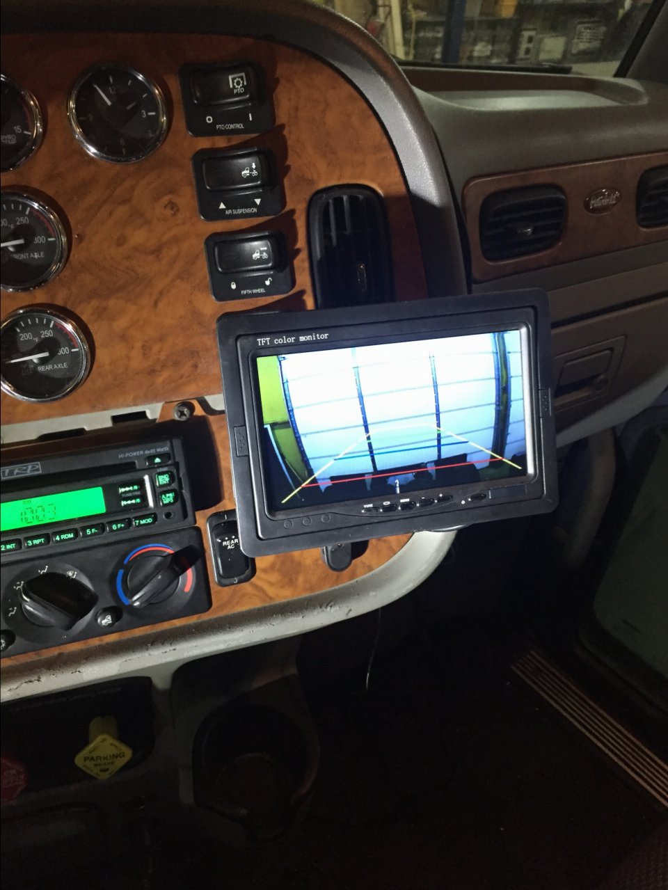

    image.jpeg image.jpeg I got one of these cameras for $18.99
    http://www.amazon.com/gp/aw/d/B005Q...kup+camera&dpPl=1&dpID=41DtXFZQCyL&ref=plSrch
    And this monitor for $24.
    http://www.amazon.com/gp/aw/d/B007S...ra+monitor&dpPl=1&dpID=51Te-mzd1jL&ref=plSrch

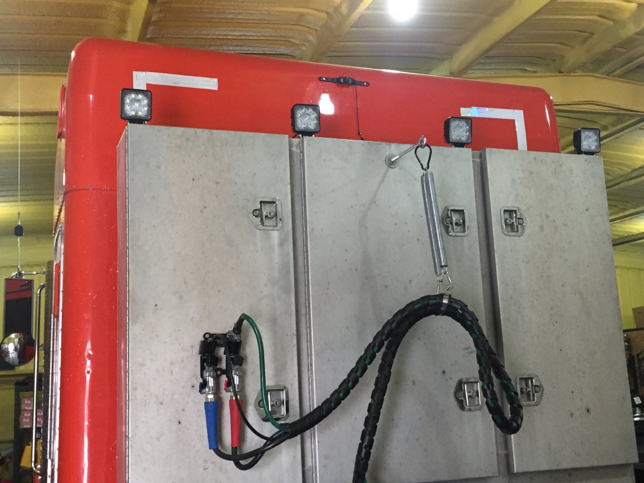

    It came with everything needed including a cable that was long enough to run from the display in the cab to the camera on the top back of the sleeper. I ran the wire down behind my headache rack and then along the frame rail and through the firewall in the factory holes.
    Took a couple hours to install and cost less than $50. Not that it is hard without it but makes hooking up a trailer a snap as well as seeing around behind an empty trailer or one not loaded high. Also helps see some blind spots when driving.
    I wired it up so it comes on when the engine is running but you can turn off the display with a button on it if you want.

    That is a good thing, especially at night. Heck with your backup camera, a qualcom, the dash lights, GPS, CB, VHF and other assorted electronic gadgets you might as well leave the dome light on.
    Not you specifically but in general. I drove one truck back from Washington for a customer of ours and I had to put my hat over the dang EOBR just so I could see. Did not waste time trying to figure out how to dim it or turn it off.

    Think I'd rather have the camera on a toggle on off, and remote mount it to the ### end of the trailer.
    Probably be handier if I had backup lights on the wagon lol

    Monitor is mounted on the dash and is bright at night but I just throw a ball cap over it.

    I've got 4 camera & DVIR(SD) self contained. The back-up helps & with what I haul I can get a good look at the load on the road, plus the cameras on the mirrors have such a wide angle that using it on blind side backs make you look like a ninja-master-super-trucker. As others said, it's too bright at night so I made a cover for it that flips up out of the way.
