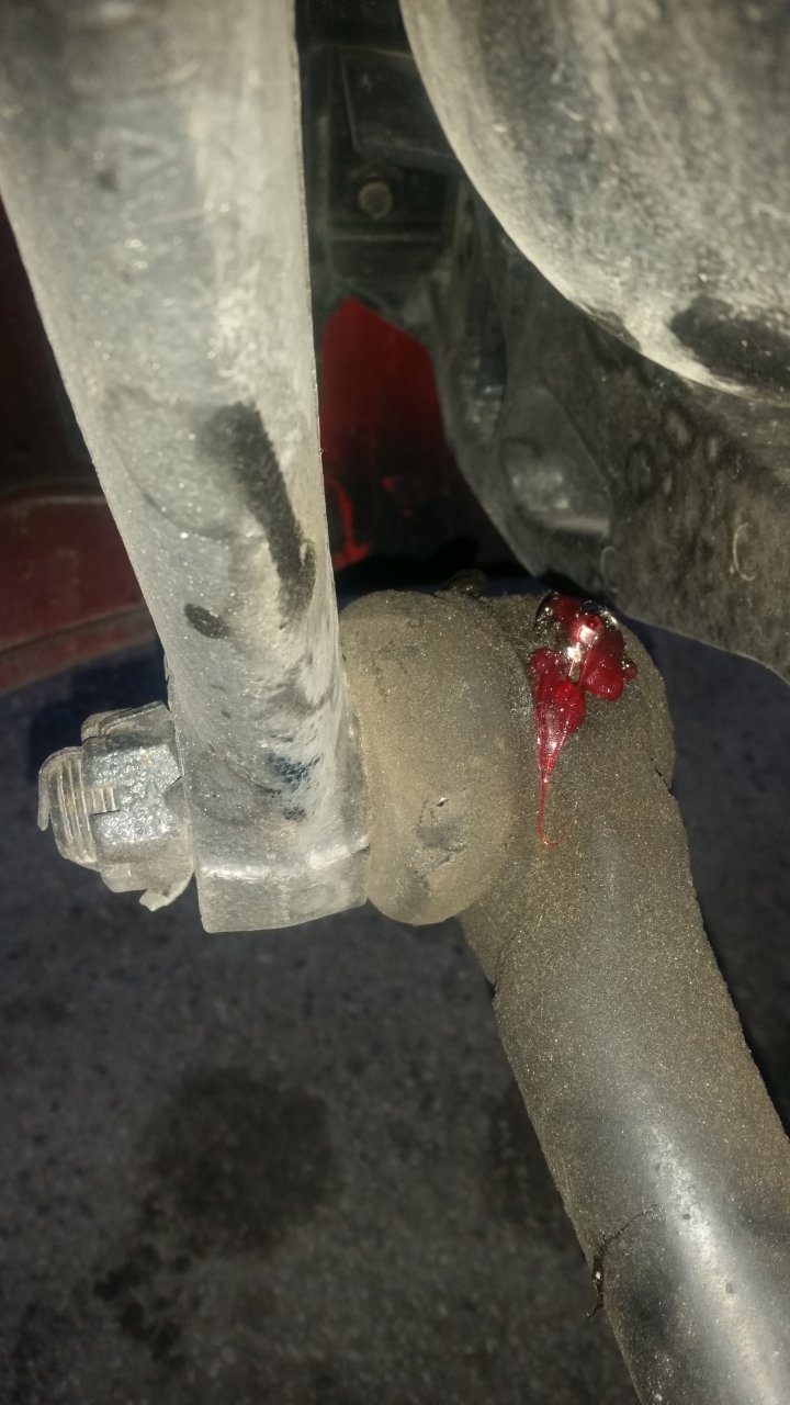

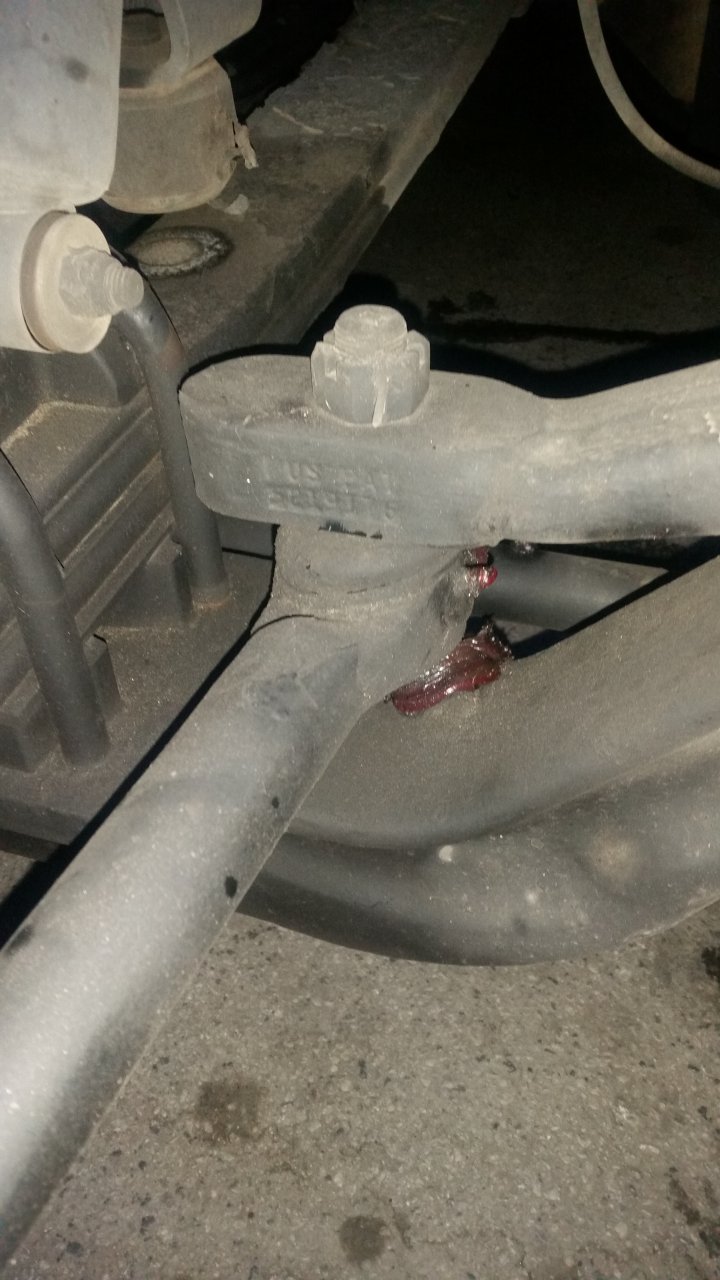

    Shop I talked to today says about 10 hours to install spring pins/ bushings and a new air dryer... Sound about right? I can do the air dryer but figure while it's in shop Id just rather have them knock it out...

    halpin'...Your Popping sound 99% of the Time are your Leaf Spring Pins.
    Inspect the Pins visually- Put a Small Bottle Jack Between the Spring and frame to lift the weight off the pins slightly- Grease the bejeezus out of them-
    Not taking Grease? Re-Zerk- Or Time for new Pins Completely- I Did Mine this Year- Both Springs- New pins Front and Back- A few shims-New U-bolts Also Rear Hangers were Cleaned and Re-zerked- 9 hour job And I Took my Sweet Time, You May Need a Torch to Heat up those u-bolt Nuts If You ever change your springs.
    Right Now- get them Greased Real Good.
