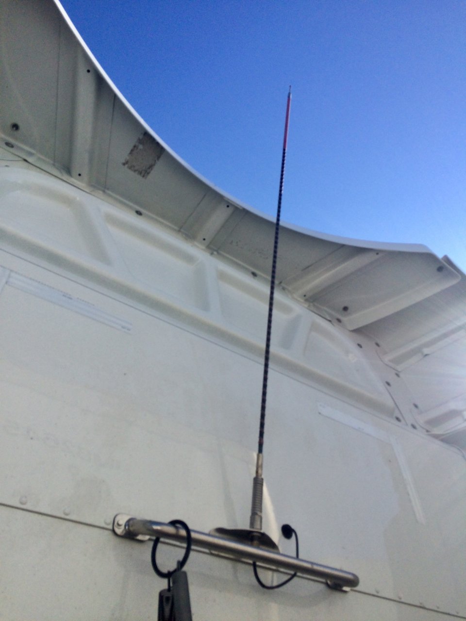

    A picture always helps.
    Here’s one I was stuck with for a month last year. International LT. Those PRO-COMM Quads were a distinct improvement over stock. But the location is a killer.
    The trailer was a tanker. Another man got into it and I used a different brand of tractor with mirror mount antennas. We’d pass waaaay out in the Oklahoma Panhandle and he’d just flat disappear in a short distance.
    Here’s what I’m working with now. 579 Peterbilt. This is a 5’ Skipshooter. Gets about 4” above van trailer. Far better than the previous picture setup.
    I’m waiting for an aftermarket supplier to finish mirror mounts for this truck. (See “Bad Influence” thread on 579 Pete Install).
    Receive can be very good. Not limited.
    And I can follow someone on the Interstate and converse at around 5-miles (hills/trees). But coax is screwy. And cheap. Needs better.
    And in passing opposite directions the other guy is gone fairly quickly.
