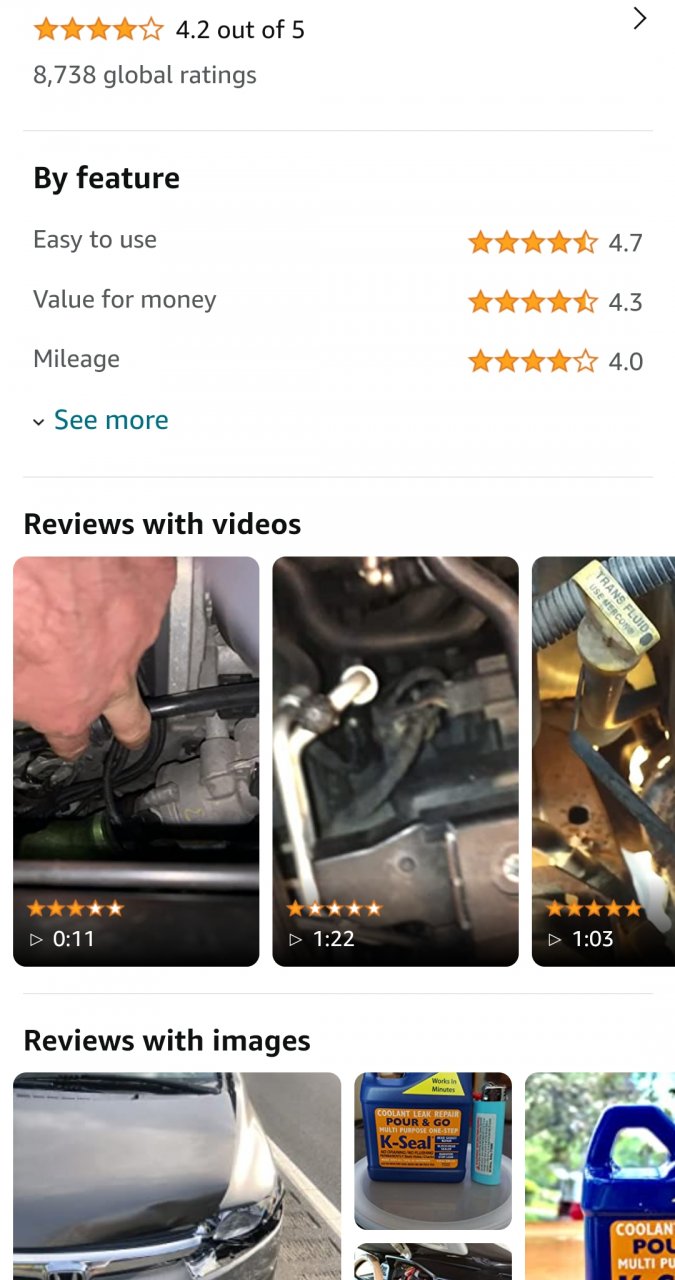

  5. Snailexpress
    2,675
    6,069
    Apr 28, 2014
    Rocky
