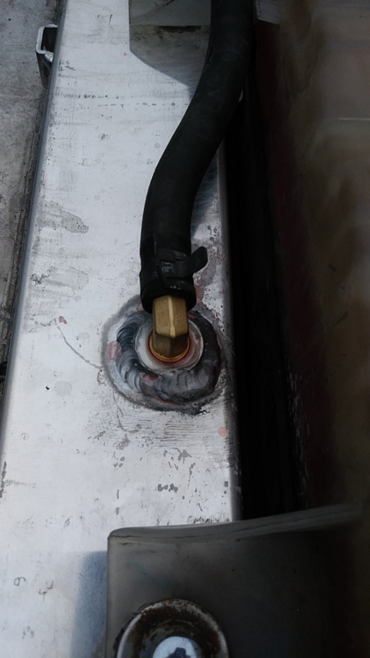

  5. Keepforgettingmypassword

  6. Rideandrepair
    17,622
    57,030
    Aug 8, 2015
    I’m sure it would. I’d use pipe dope myself. The little white bottle from permatex. I use it on everything. There’s higher rated stuff, like. Give Me the Green Stuff. Home Depot sells a Blue one that’s supposed to be real good. Anything will work. It probably just needs one more clockwise turn.

  8. Elroythekid
    Elroythekid Road Train Member
    2,626
    5,678
    Sep 9, 2010
    Halifax Nova Scotia
    There is NO fixes in a bottle. They are temporary at the very best, and usually cause problems down the road. Fix it right. If it's the rad, find someone who can braze it a little, if it's one of the new plastic, aluminum reads, replace it.
    Not to repeat myself, but..
    There are no "Miracles in a bottle"
    Just snake oil.
