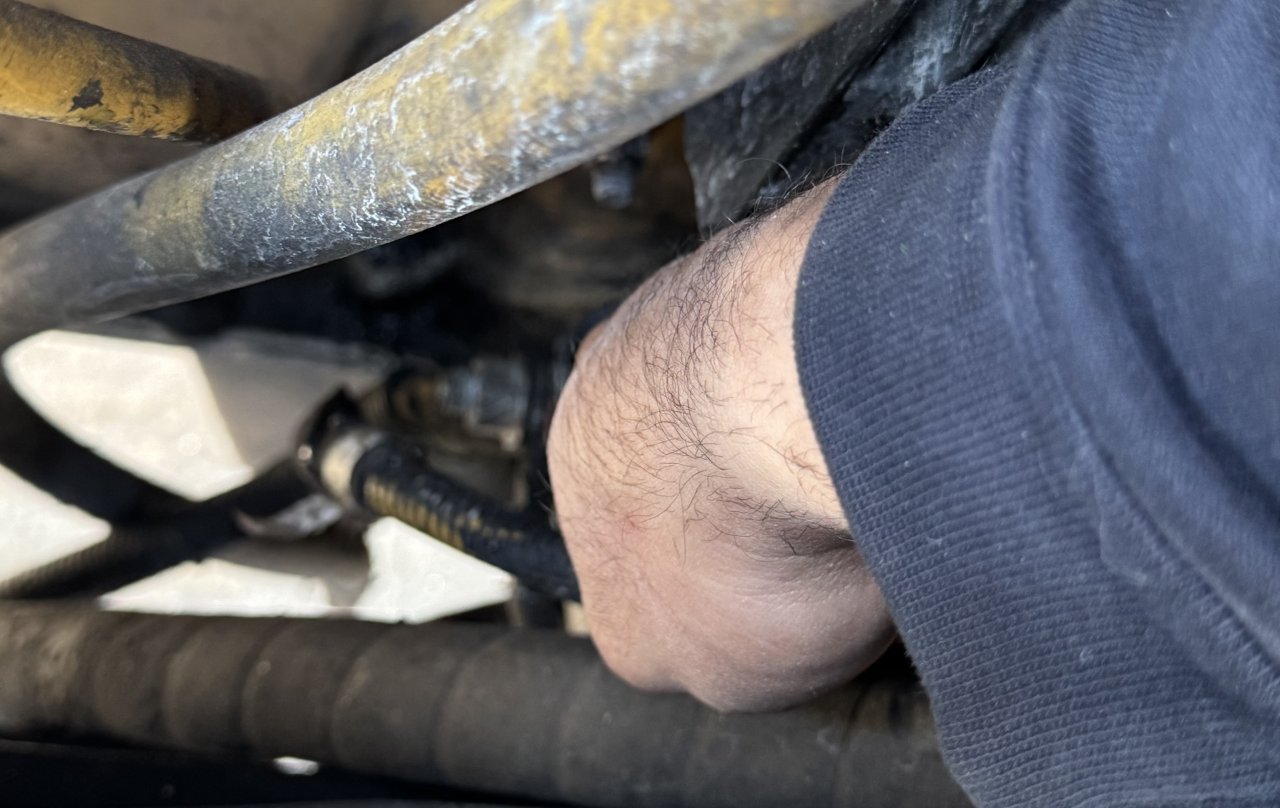

    So i traced the positive lead from the alternator to the ecm area and found this wire been cut from the positive side of the starter, I can’t tell what is it for

    Thanks for all your help, I found one ground cable been cut by the starter, fixed it today and the charge went back to normal
