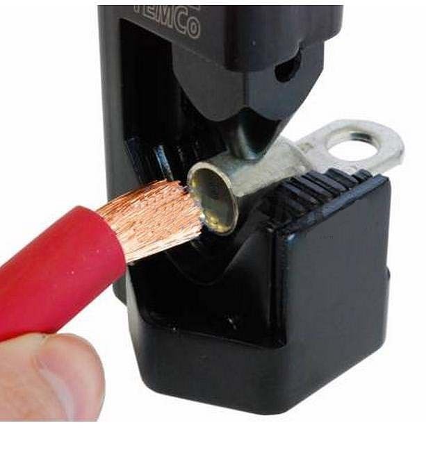

    I make my own. I use a crimper that you hit with a hammer. Does a nice job.

    If you're gonna make your own cables I'd put heat shrink with sealant over the crimped area of the lug to keep moisture out of the wire.

    You just made me remember i have one of thoes tpols i use it to swag cable ends thanks
