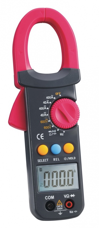

    The Amp meter pictured shows if there is any current being drawn... it's a simple on/off device that clamps over your negative or positive (it'll just read +/- depending on hookup) battery cable. then, do as advised... pull fuses or plugs one at a time until you find the source of the current draw.
    Good advice and they aren't expensive.
    Keep us posted... I too would like to know what you find.
