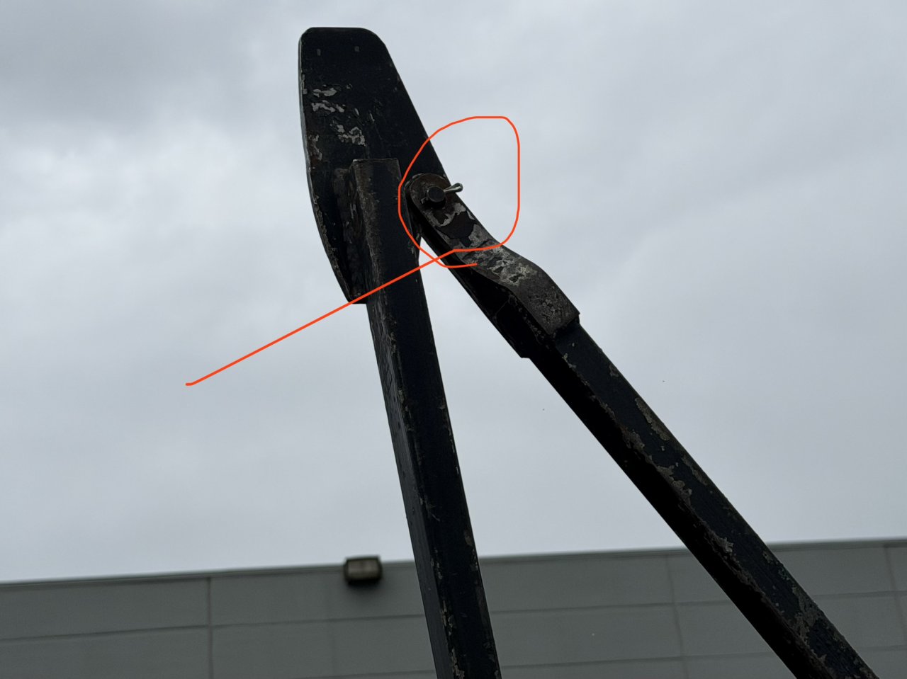

    IMG_0762.jpeg IMG_0761.jpeg Hey folks! I’m writing this from the hospital room!
    I learned a tough lesson today. I have a mild concussion from getting whacked in the head by the bar that pulls the tail of my conestoga tight. A pin came out coming down the road, and when I let the tension off to open it up, it tomahawked my head.

    That cotter pin in the first picture isn't installed correctly. It either needs to be pushed in further or replaced with a longer one so the legs can be bent over to secure it.
    I hope your company is taking care of that injury under their workers comp insurance.

    Glad your OK and good on you for posting. But yes that cotter pin in the pic, if not just popped back in, and even then is a disaster waiting. Installed correctly there is no way it can some out of it location unless it sheers. But its job is not to take the load, just secure the bit that does. So may have been installed poorly initially. Not looking to blame but lucky it was not your eye.

    Looking at the pic he posted, it definitely has the wrong cotter pin. Most likely a Friday night build before beer:30….
