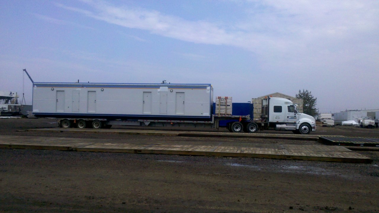

  11. not4hire
    not4hire Road Train Member
    7,142
    26,957
    May 16, 2012
    Calgary
    All you had to do was ask. :D
