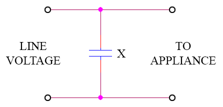

    Does anyone have any advice on how to remove static noise radiating into my Uniden 980SSB c.b.radio that is coming from the blower motor on my truck?

  7. rabbiporkchop
    Joined:
    Feb 9, 2012
    Messages:
    9,681
    Thanks Received:
    6,537
    Location:
    Wapwallopen, Pa
    How about this?
    That's a cheap way of dealing with it.
