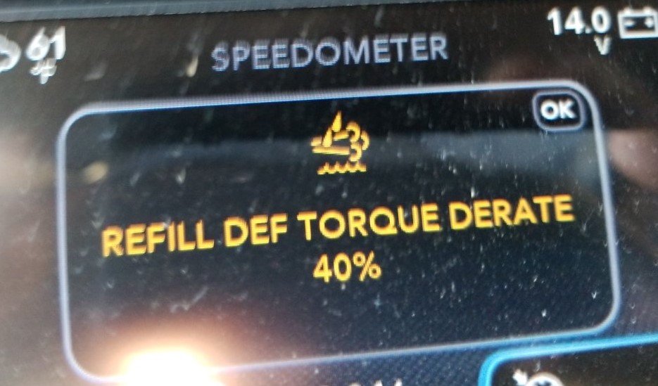

    Hello Guys, "DERATE DEF BEEPING"
    ISSUE: Beeping Noise will not stop - related to DEF -
    ** I filled Def to full - still the beeping continues and error still on dash.
    The truck is a new ProStar 2019 - 5.000 miles on it - VIEW IMAGE BELOW
    I have turned off truck 5 times already and over night - still beeping - non stop
    QUESTION - How can I clear this code error or this to make it stop beeping?
    Thanks in advance !!

    Did you run it empty?
    I did once on my Detroit,it ran out just as I came into my yard.
    It acts as a tattletale, may need to reset it using factory diagnostic software.
    Or the level sensor is acting up.

    The level sensors are ultrasonic and probably acting up. If you filled it, then you need to take it into the shop.

    I drive a 2018 International LT and to clear a code I have to take the key out of the ignition for 10-15 mins.

    Guage broke in def tank?
