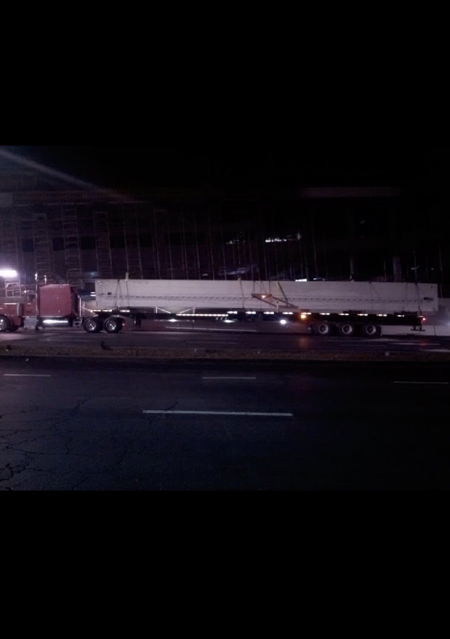

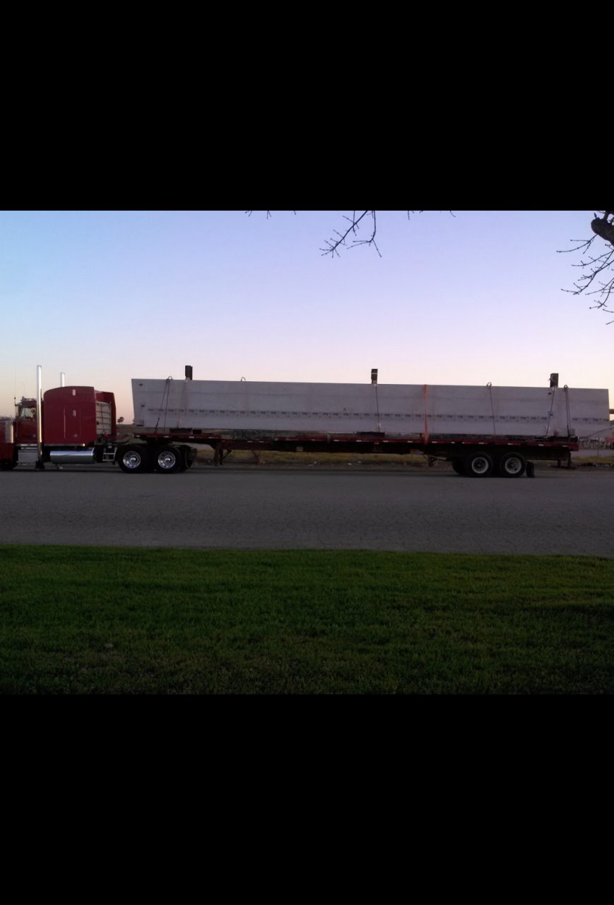

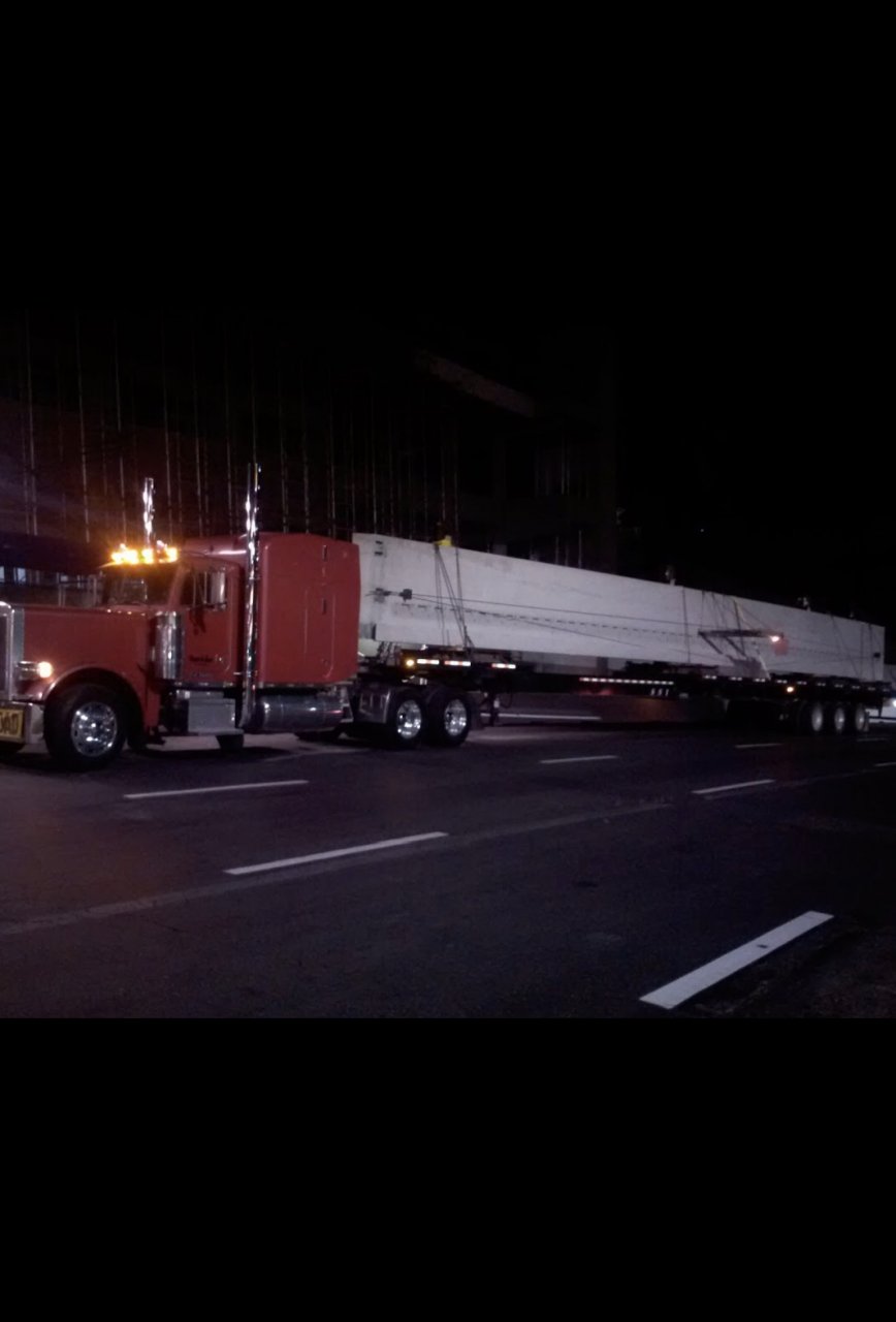

    No load
    this is the particular load I was referring to with the jo dog.
    Anything he could have done differently? Any way to shim a non modular trailer?

    Not really. As soon as you start stretching the trailer the rating drops. The beams just aren't thick enough with enough overlap to support that kind of load all the way open.
    I don't think I'd agree to pull a load that looked like that myself. Maybe across town but not cross country.
    If the load can't help support the trailer then you really need to use a modular that can be shimmed properly.
    In your pictures the trailer is already bending negative. Every bump you hit makes it bounce even further down putting even more stress on the limited overlap between the inner and outer frame. Only a matter of time until that causes a failure.

    Works a bit different with a stretch flatbed and your nice solid load that isn't trying to bend itself in half.
    With a stretch flats loaded like you are the load is putting all the weight on the 2 ends over the king pin and the axles. I bet it would start bending if you put all your blocking in the middle between the KP and tridem. That block at the back is pushing down on the back and lifting the middle helping it stay flat.
