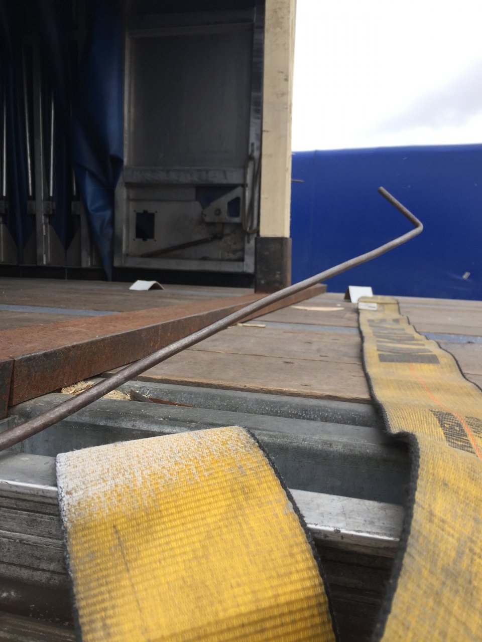

    I use a simple piece of 6ft x 3/8" steel fuel line with a J bend on one end to pull chains and a L bend on the other to push or pull straps.
    It's flexible enough to contort between different layers of a load that aren't a straight shot across the trailer, but strong enough that the J&L bends don't easily lose their shape (unless you yank the snot out of it).
    I also use it to snag edge protectors off the top of load after I'm unstrapped and ready to deliver. IMG_0300.JPG
