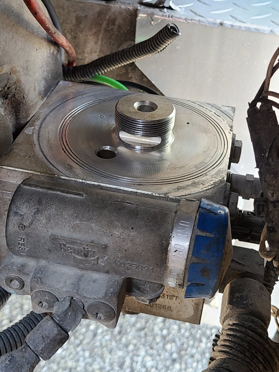

    There is what looks to be a keyway at the bottom of the threads. There's an O-ring in the new filter box (TRP p/n AC1001) that will fit over those threads and snug up against the base but it will absolutely obstruct that keyway just a little. What's the purpose for the keyway?

  3. ibcalm19
    ibcalm19 Road Train Member
    1,463
    2,435
    Nov 30, 2015
    Pennsylvania
    Air flow. The o-ring will expand when you screw the filter onto the base. Put it on see how it works. You should be fine

  4. Goodysnap
    Goodysnap Road Train Member
    3,773
    9,199
    Jul 12, 2017
    No small oring from the factory on ADIS. Throw it away. Lube seal on filter and put it on.

  5. spindrift
    spindrift Road Train Member
    3,235
    12,916
    Dec 2, 2014
    Texas
    Someone had previously installed the old O-ring. Could it have done any damage?
  6. Goodysnap
    3,773
    9,199
    Jul 12, 2017
    I doubt it. But it doesnt do anything either.
