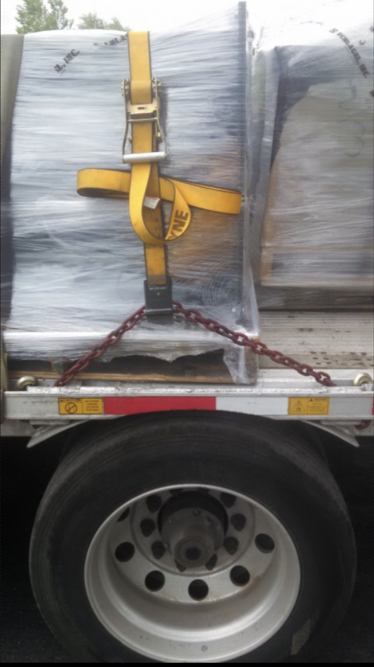

    Do what MJ does and what I’ve done too, use a short chain.

    It’s the winch side that’s the issue. My current transcraft lets me slide the winch directly over my tires on the rear axle. With low pro 22.5 tires and the air completely out on the trailer there’s still a 3/4-1” gap between tire and winch. Ratchet straps would work but I don’t believe they provide the same tightening power as a winch strap. You probably couldn’t even get it half as tight.
    I guess I’ll just have to deal with pocket winches.

    I don't even carry any other straps. I go around a spool or go diagonal just in front of tire on one side to just behind tire on other side. I'm sure some won't agree but it works for me.

    Had to do that with an oversized tank I hauled out to W Tx but it was because my straps weren't long enough. Didn't think about doing it over the tires. Thats a good idear.

    That's a darn good idea. Gonna go buy some short chains and hooks.
