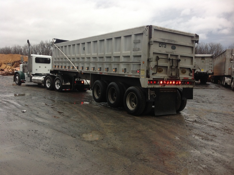

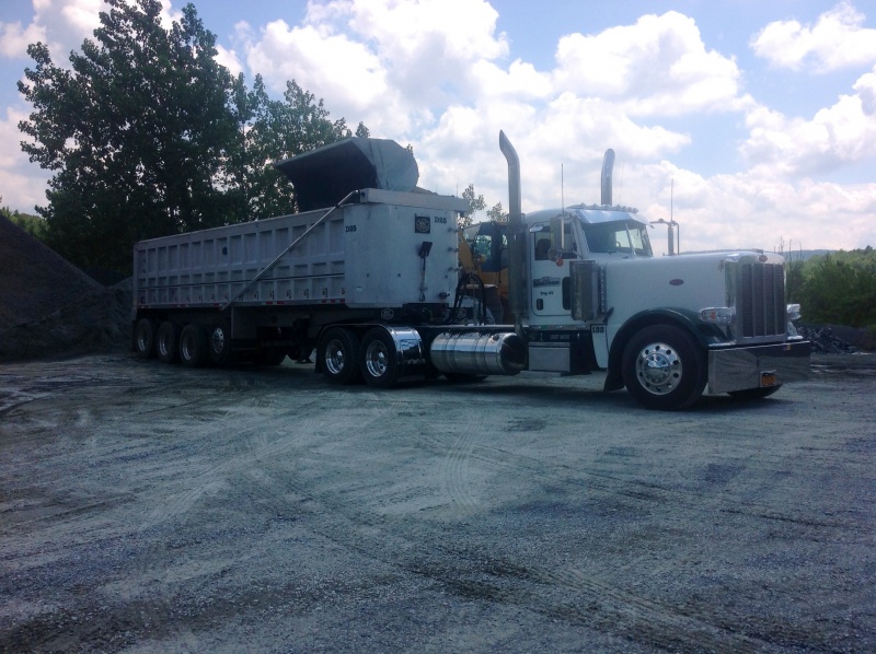

    Thanks for the comments now it's all one color the interior is all complete with no rips or pieces missing or add ons. Here's it now [​IMG]
    blade Thanks this.

    Before and after
