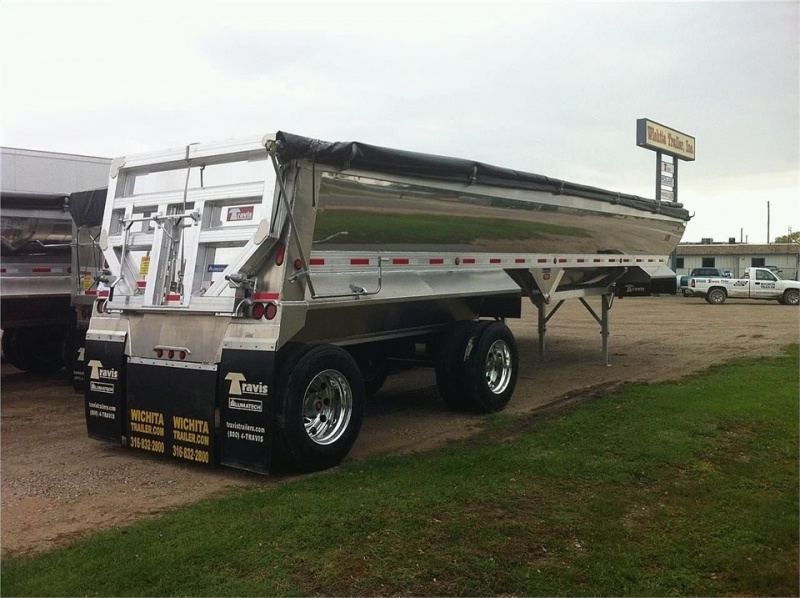

    Im looking at purchasing an Aluminium Enddump capable of many different types of work.
    My favorite that Iv seen so far is Alumatech which if I'm not mistaken is manufactured by Travis now.
    I like this half round type as it's better for hauling dirty dirt or aggregate much like the steel end dumps we currently run but I'd like to be able to haul agracultural products also.
    Can anyone recommend the best and most lightweight trailer that might fit my needs?
    Ill try to post a picture of what catches my eye at the moment.
    Cheers!

    I work for an agriculture company and most all of our fertilizer is delivered in MAC dumps like the one you have pictured. They are frameless spreads with front lift axle. They are nice trailers, but pricey! You better have some money saved or have some good steady customers if you spend that much on a trailer. The guys that haul our stuff run lots of concrete materials when they are not busy hauling fertilizer. Its hard to spec a dump to be good at everything.... focus on an area you feel like serves your customer base best and order a dump that suites that industry. Good Luck!!!

    Personally I like a Travis, Trailstar or a Vantage. I have a Vantage Smooth side now. It came with a factory installed liner which I hate because it's a PAIN to clean under it which it needs periodically because dust builds up under it. 39 or 40 foot is the length I like and it's legal for the bridge, axle, and king pin laws. Sides at 56" 0r 63" handle pretty much anything I'm going to haul. I like a 3-way gate. Cross members at 12 or 16 inch centers so it's forklift compatible and dock height. I also have an electric Shurlok roll over tarp cause I'm getting old, fat and lazy. I like the Alumatechs for the weight savings but I don't like the 2 tons I loose because of the rounded sides when I haul cottonseed hulls or similarly light product.
