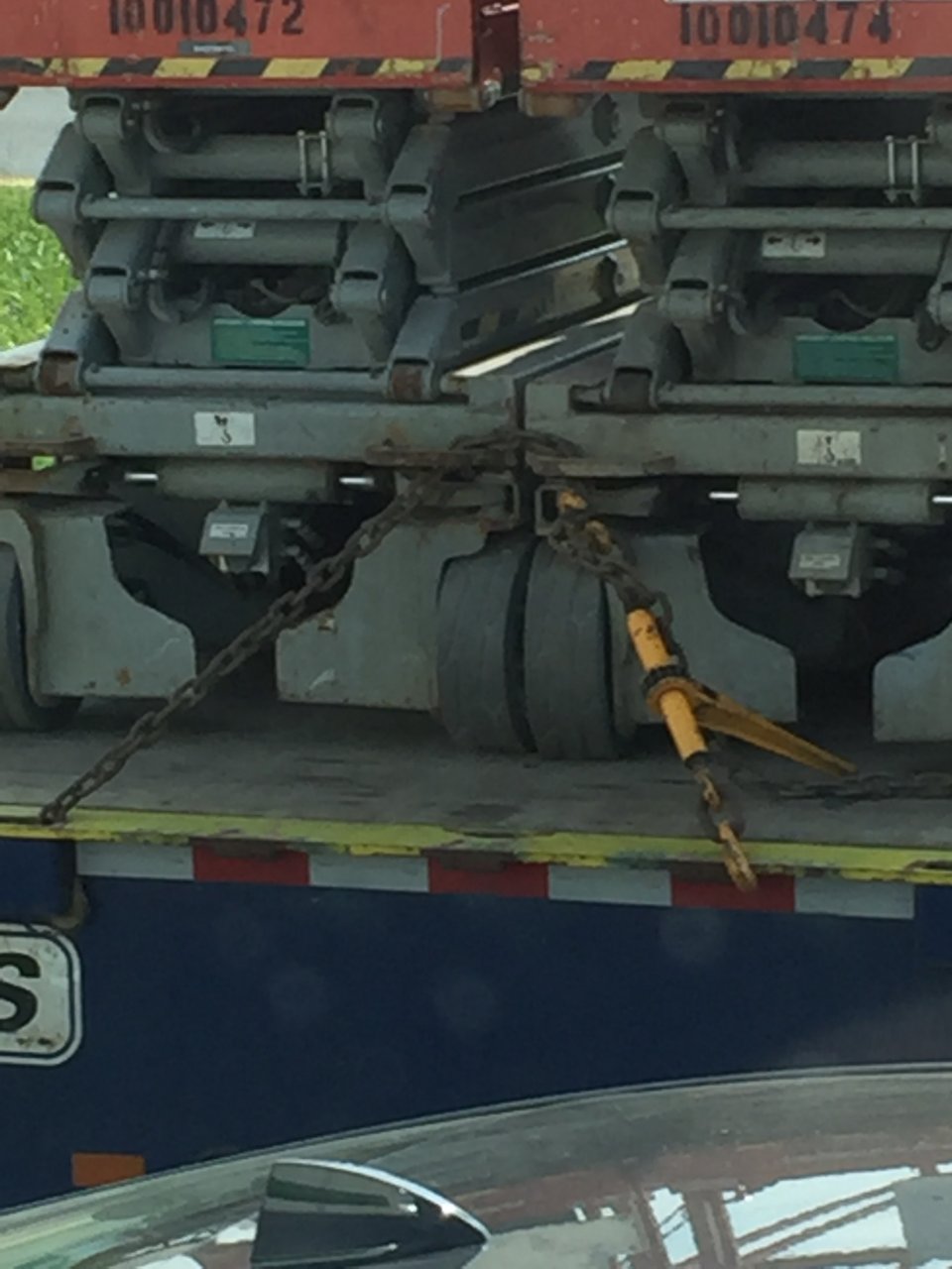

  3. MidWest_MacDaddy
    11,427
    19,556
    Feb 21, 2015
    South Carolina
    Newbie Question: what makes this wrong?
    Not saying it's right, just learning here.

  5. MACK E-6
    50,252
    240,656
    They can explain the theories behind the problem with that better than I can.
    But IMO those should have been a few feet apart to allow for chains at all for corners on each lift.
    Just my .02.

  7. m16ty
    m16ty Road Train Member
    2,274
    4,964
    Jan 22, 2016
    Worse people around here are the farmers and landscapers. 99.9% if tractors you see hauled around here have what I call the "farmer drawbar rap". They will take one chain, rap it around the drawbar, add a binder, and call it good.The really lazy ones won't bother with the binder, they will just hook it as tight as they can and truck on. You will also be hard pressed to find a skid steer with more than one chain on it.
    The pic of the manlifts isn't all that bad IMO. Not legal but it should hold. The worst thing is if they aren't parked tight against each other, going down the road the chain would get loose. It does appear there are some sort of stops welded under the outer rail to keep the binder from sliding.
    On the original pic, I have to believe somebody staged that setup just to get a laugh. Surely nobody is that stupid but you never know.
  8. cnsper
    cnsper Road Train Member
    5,869
    27,421
    Feb 28, 2014
    Binder is hooked to the lip of the trailer frame. There is nothing to keep the binder from sliding to the left and now you have a lose load.

  9. tucker
    tucker Road Train Member
    12,647
    40,425
    Jun 13, 2008
    IN
    @m16ty saw it, there are blocks under the lip to keep the binder from sliding
  10. johndeere4020
    8,522
    119,296
    Jan 1, 2010
    Yeah but that binder isn't against them look at macks picture the binder is in the middle of nowhere it can an most likely will slide then it's like @cnsper said loose load. When I have guys help me chain they always do that and I try to show them why you can't. If you're going straight down or up against something it will work but at an angle like that won't. It's the same as throwing chains over things, you kinda have to mess with them to find what I call they're "natural home" if you put them at a weird angle or whatever they will move around and get loose. Who hasn't been tightening a chain and had it right as heck then in the next pull of the binder the chain jumps and is loose?

  11. johndeere4020
    8,522
    119,296
    Jan 1, 2010
    Those are small lifts they only need two chains each and being close isn't a problem just needs two more chains.
