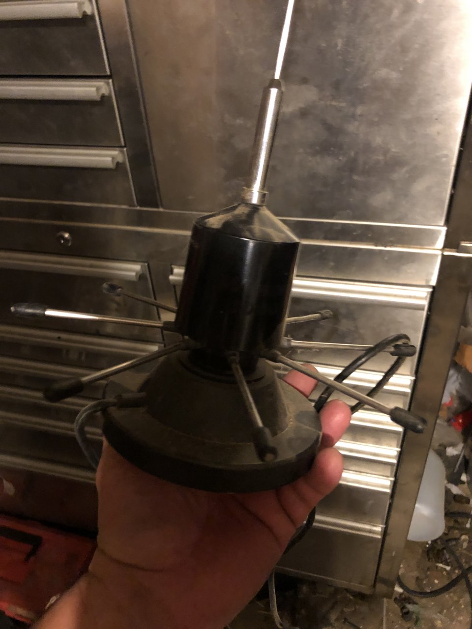

    I have this Wilson 1000 magnet mount I use with a Galaxy DX 44V on my Mobile once in a blue moon. Does extremely well. But it’s one of the original Wilson’s, not the knock off Barjunk starting making when they bought them out. B0DC6D1E-086E-4ECC-BC0D-F3F7EFD8C351.jpeg

    How far do you get with that antenna? I've only owned the lil will and it reaches 5 miles.

    You can see it’s been collecting dust. I haven’t use it on any on my newer cars. Didn’t want to scratch the paint on the rooftop. To answer your question, depending on the area, done 5 miles easily and some, you know how it works, depending on conditions. Honestly, I never pushed it cause just use it on my commuter car. Now I just use gps Waze or google maps for traffic. But just keeping for a back up or an emergency just like in your case in the future.
