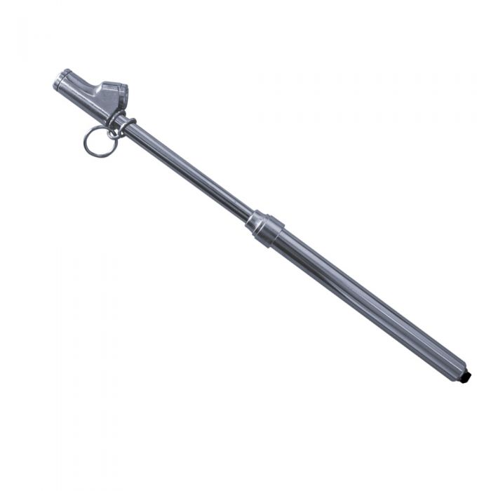

    FYI, piston-plunger gauges typically only meet their accuracy (closeness to known value) near the middle of their range, with the same temperature air pressure etc...
    It may be 4 lbs of error of on a 72 degree day but not when it is freezing or in the middle of the desert with a stick gauge.
    What they do have is precision...at least with repeated measurements on the same tire.
    Accuracy = distance from known value
    Precision = repeatability of values in same conditions.​
    The big problem with those pencil types if if you are running say 17.5s with air valve extenders. Even if they both tires read the same pressure the inside tire could be seriously overinflated if the air valve extender restricted flow causing a lower reading.
    Digital and dial gauges which don't depend on that initial acceleration like the stick versions are about the same price but much more accurate, especially when comparing multiple tires.
