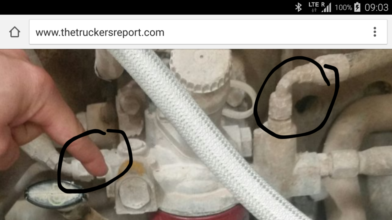

    You have to prime the fuel lines where they enter and exit the head.
    Follow the supply from the filter to the head. Loosen the fitting and hand pump till full fuel flow.
    Do the same at the back.
    It's a five minute job.

    The resistance is usual when nothing is open and pressure is built up you can't push in the pump.
    I did a bit of a photo job of your picture. I've circled the two lines I was talking about on my previous post. Follow those lines and prime them where they enter the head. 2016-06-11 09.05.24.png 2016-06-11 09.05.24.png
