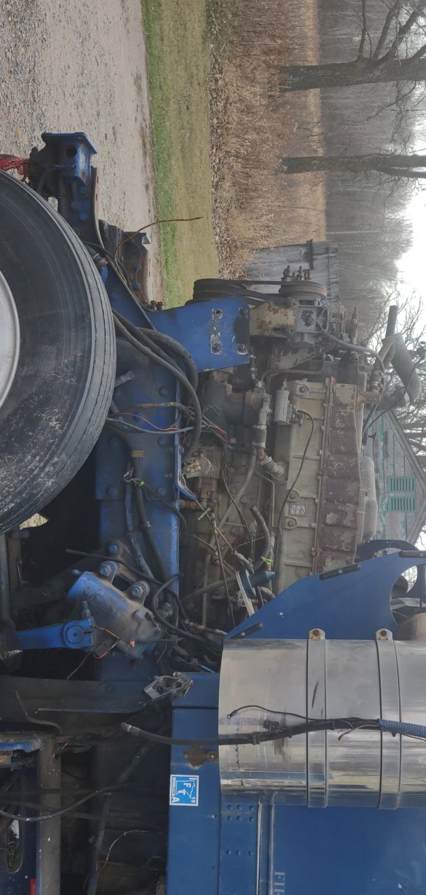

    My 1979 K100 has those same mounts you have posted on your old COE. Just curious why/if those wouldn’t work on the 900. Seems to me it would be a factory mount to start of with, unless the COE and Conventional are different.

    Different size holes in the frame. I didn't want to drill the frame

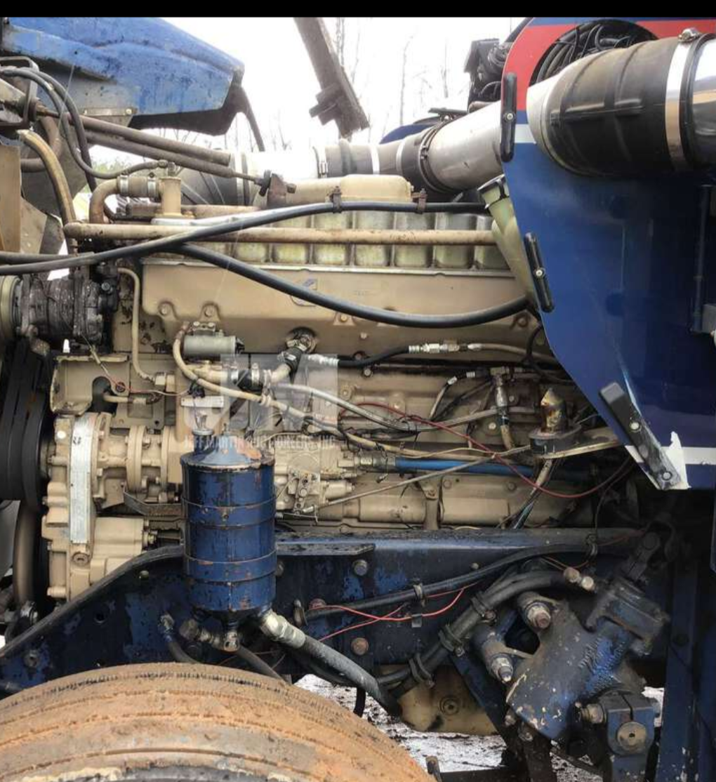

    The mounts won't work flipped over. The tabs would be angled upward
    Not sure if it helps but here's a picture of my engine. You can see how low the rear mounts are

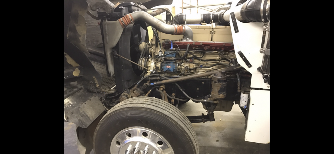

    Engine in my W9 is angled as well, looks correct to me. I have a big cam in a 94 Glider….

    Not angled drastically but is angled low in the rear. This is my 1995 W900L with a Big Cam….

    I'm going to measure the front support I'm starting to think I might need to swap it

    Well from your picture I definitely have them upside down Mount plate placement...

    Well winter don't give up it's grip in Minnesota. The mounts I have are not right. So I can not find the correct mounts to save my life. Just going weld some new ones. Question is how thick of steel do I need? I know a few have built there own.
