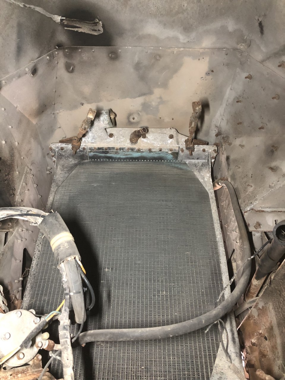

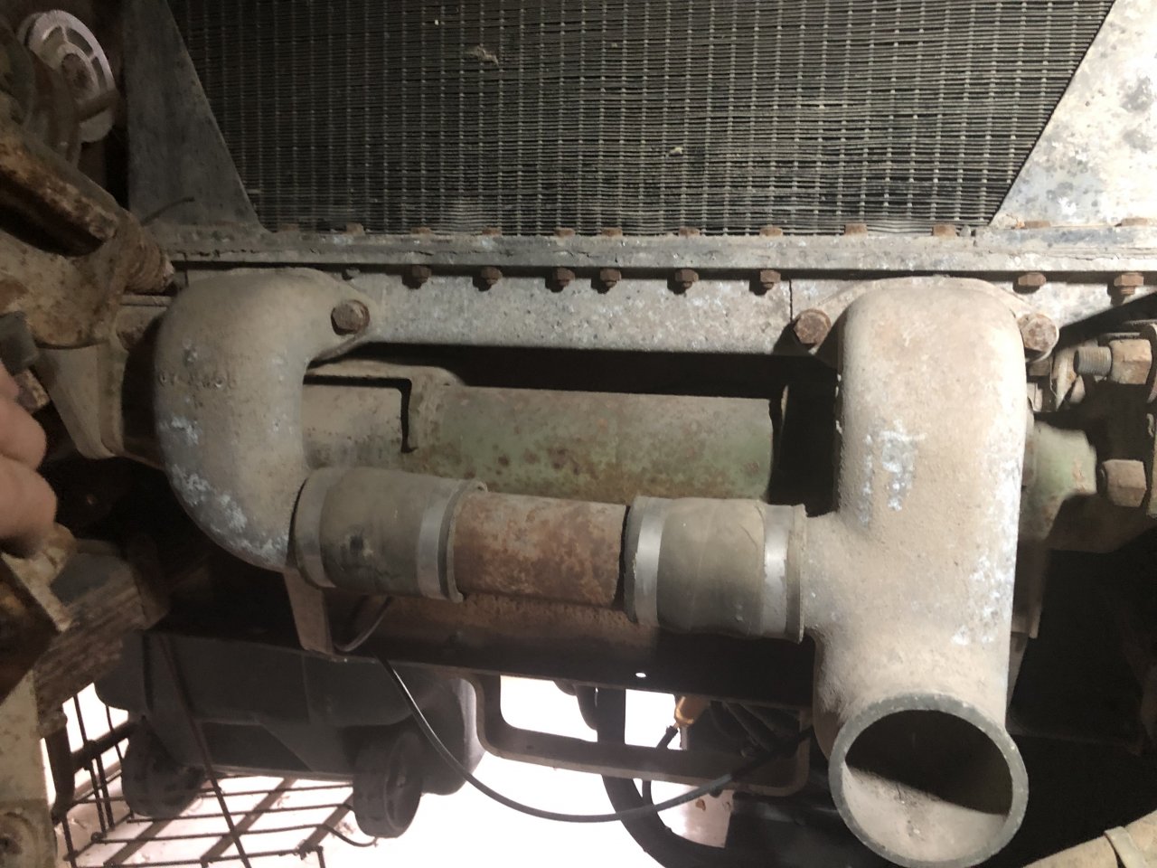

    5023B1AC-1DA2-4302-9457-9251A472065A.jpeg F3B7B853-998C-43EA-B490-82D48449D167.jpeg This what i’m referring to. This is the radiator in the 352. It is 1050 square inches. Pretty close to Kw’s size I recall. You can see the plate I’m referring to on the top tank. The cat pulled from the left and a Cummins is going to use that right side hole. On the bottom the Cat pulled from both sides and Cummins will only use the right side. So I have to cover left hole with a plate. Also cats used bigger dia. hoses to water pump and thermo housing than Cummins.
    This was the setup for a 1693. Not sure if the 3406 was same.
    Adisiwaya and BoxCarKidd Thank this.

    I’m not sure why Cat pulled from the bottom with two outlets. I was told it may be because it had a brake saver and needed more cooling flow faster. But this truck has no signs of ever having the controls for it in the cab anywhere. No scars from the extra trolly valve to be found.
    Problem I have is the engine has been MIA for 32 years and all the folks I know that had any first hand experience with 1693’s or this truck have passed on.

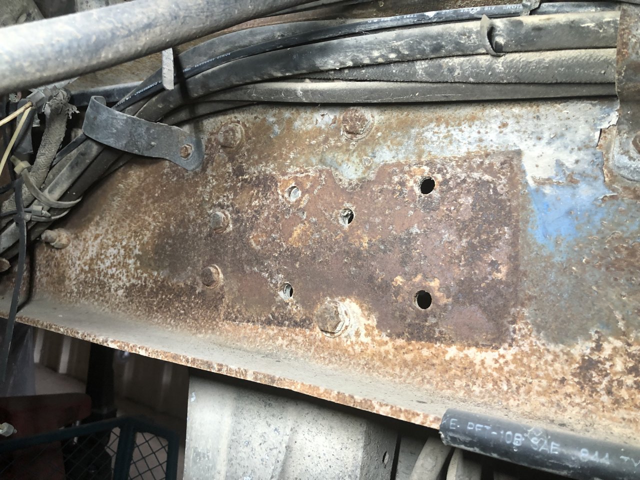

    E1D70369-C3E7-4BB0-AD6D-5C9B078389C2.jpeg Engine mounts were different from Cats to Cummins back then. They were much bigger and different shape. But like I said not sure on the 3406.
    When the engine was removed back in 1990 the rear mounts were removed as well.
    The truck and engine were pushed back into a dark corner of the shop and shady family members on my uncles married side “borrowed” everything years ago. So I’m sure statute of limitations are up. Lol!
