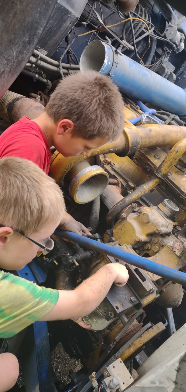

  11. Adisiwaya
    Adisiwaya Light Load Member
    252
    326
    Mar 25, 2017
    Well trying get the cat all tore down if anyone needs some 3406b message me. Kids are having a good time taking everything apart Snapchat-1389167568.jpg
