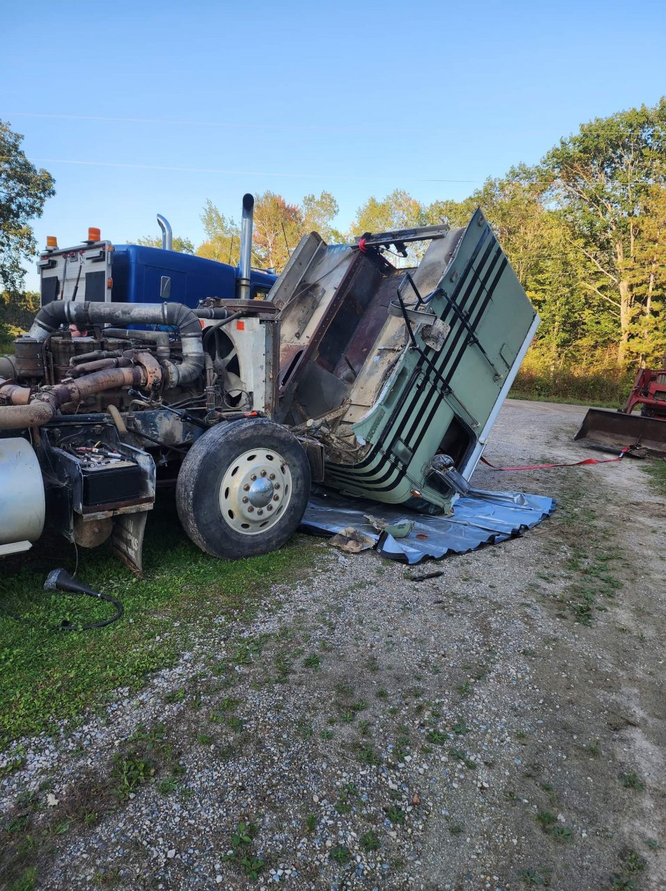

    Well got the cab tilted over now guy is picking the cab up tomorrow morning.
    There all three of my trucks. Well 2.25 now
    Snapchat-2091711277.jpg Snapchat-2034993859.jpg Snapchat-117095468.jpg received_755060962255949.jpeg
