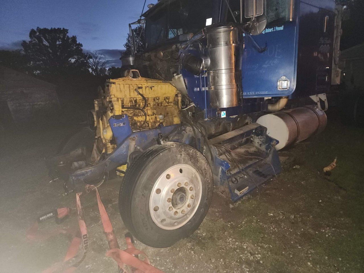

    Well trying get everything done knocked my head bad taking steps off the w900b called it a early day Snapchat-880164707.jpg

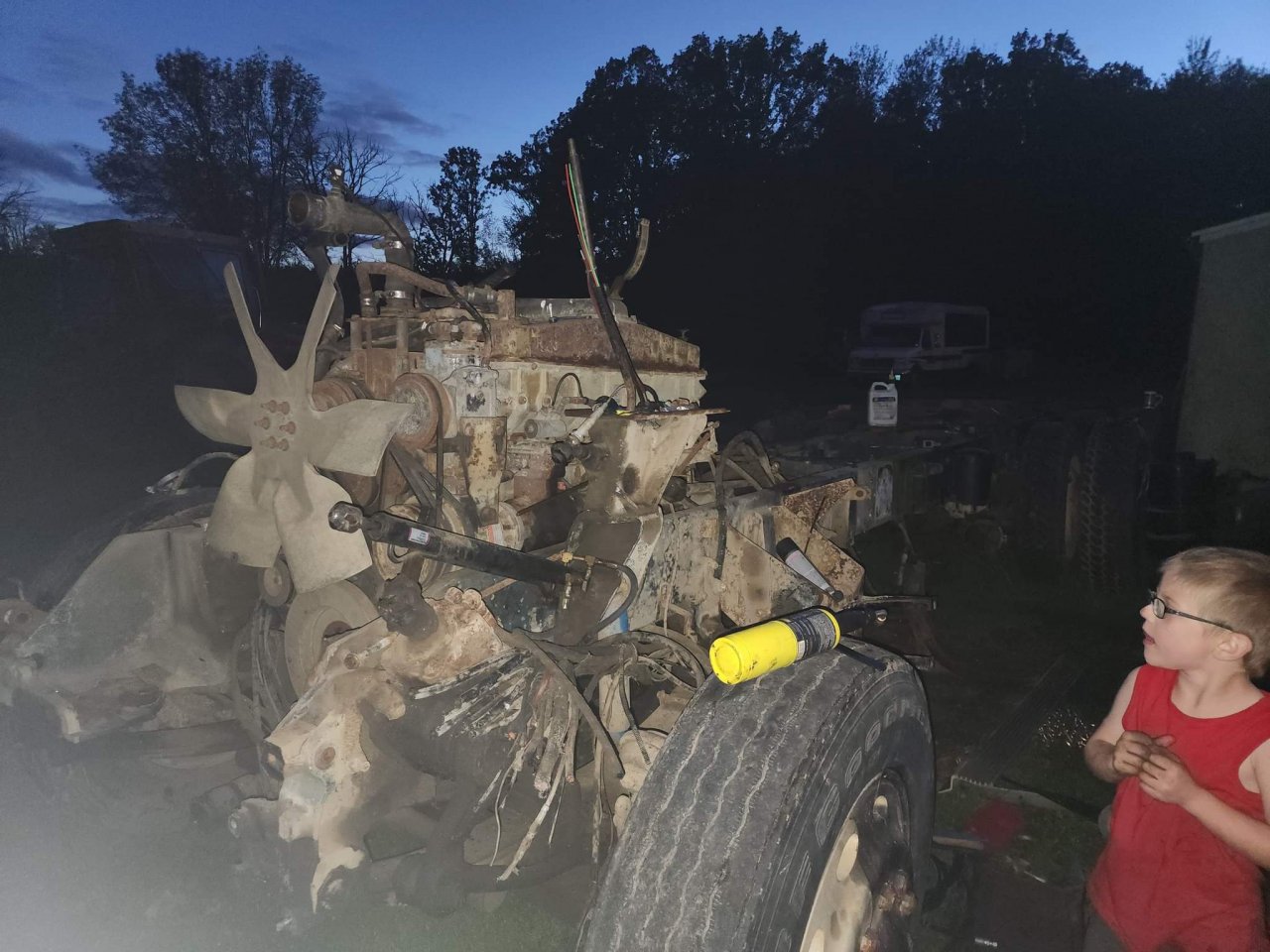

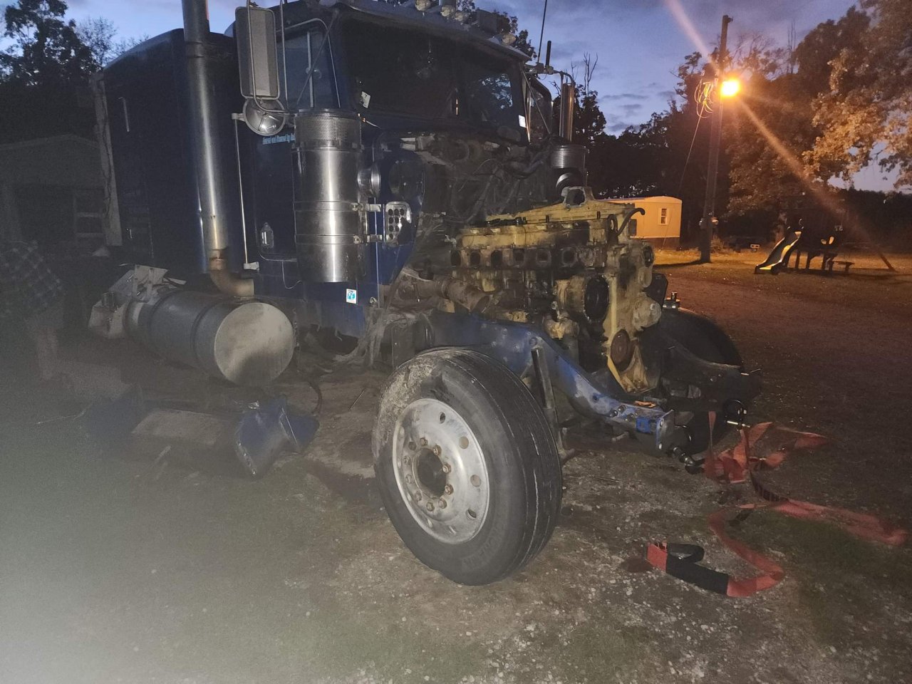

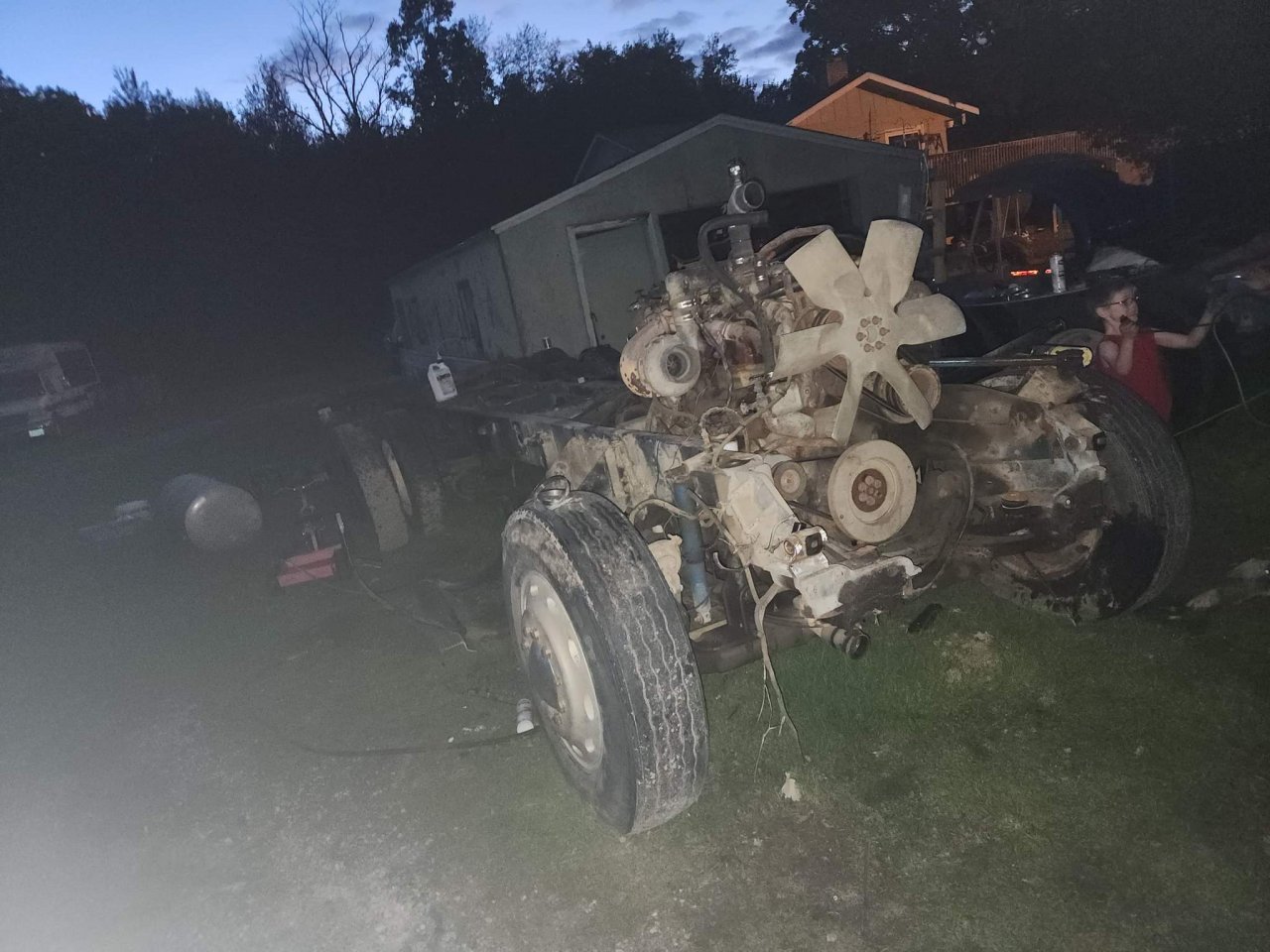

    Bumper, front bar support, rad drained, rad off... Un did the bolts on the u joints last night I'll pull them tonight. Getting there. Lot of work to do by myself and having my boys help after school. Lot of heavy stuff to do by myself. I feel way behind
