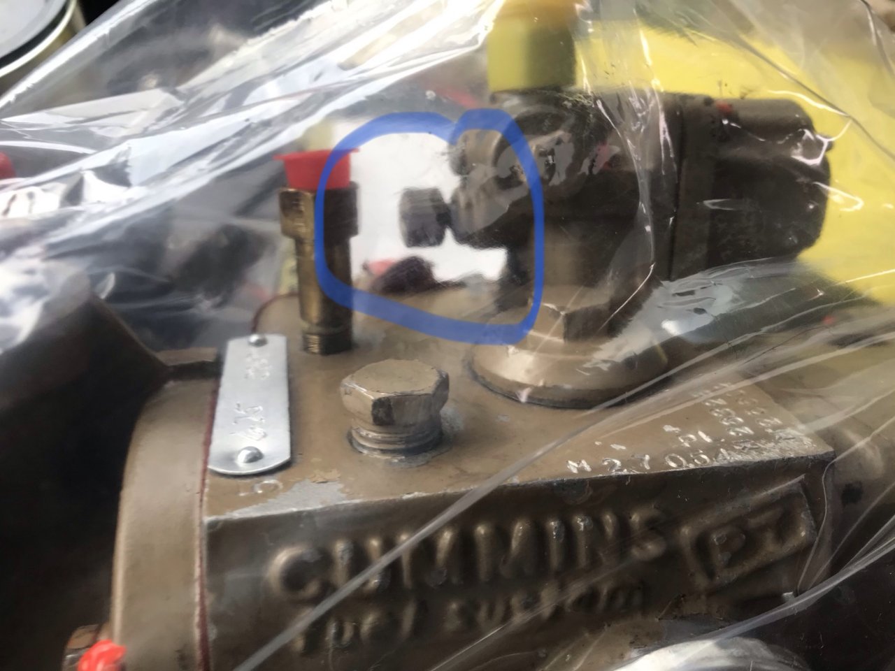

    Yes Sir! :) I just had this pump built to CPL 625, circled is the knurled screw to override the solenoid for those that may need it sometime.....

    But NEVER do this on a small cam because they lack piston cooling jets.
