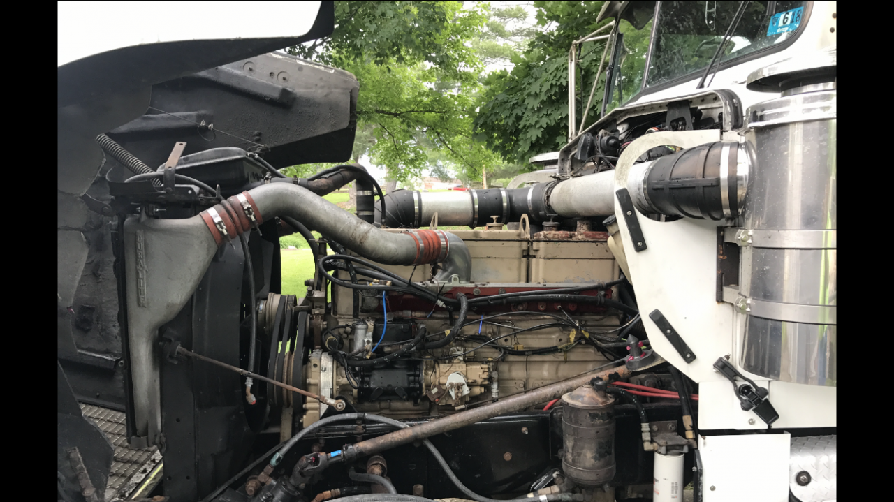

    Does anyone know how to read the following badge on a mid-1980s Cummins?
    It reads as "85NT400DBE4".
    I've read that "88NT" or "NT88" was definitely a Big Cam IV.
    But I have searched & searched & searched and I can't find anything on "85NT".
    Is it safe to assume that the "400" means 400 HP?
    And I don't know what "DBE4" means.
    Thanks to anyone who can decipher this thing.
    PS: Pictures of the engine here.

    Looks like a big cam 4 going by the intake.

    I take it , it had a electrical short that has been bypassed.

    That is definitely a big cam 4.
    I think those numbers just mean it's a 400 hp big cam 4 that was made in 1985 for the 1986 truck.
    Call Freightliner with the VIN number and they can tell you what the original engine was for that truck. If that is the original engine it's definitely not the NT 88. That was a later version of the big cam 4 before the actual mechanical n14 came out.
