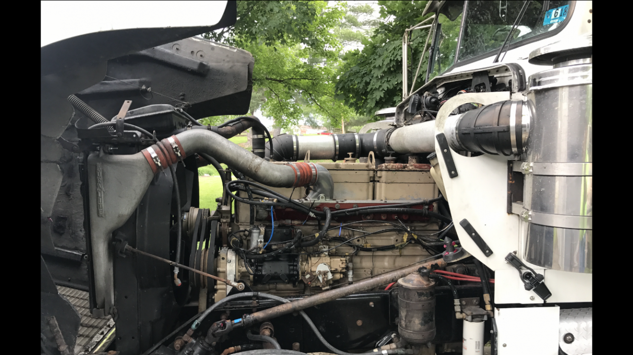

    Yes, my Pistons were ordered for CPL 586, which is the 475hp engine. Throttle shaft is drilled out larger diameter, bigger gear pump, dual fuel line, plus a lot of other little things. The air to air helps keep my egt's down on harder pulls. I run a lot of I-77 from Charleston, WV on north. Very few times my trans comes out of OD with a 15613 trans and 3:70 Rockwells.

    That's a good looking setup,Oldskool. I always wondered how an old NTC would perform with an intercooler setup,vs. the old aftercooler. You've basically made a mechanical N-14,which in my opinion is the best way to go. The reliability of a N-14,without the ecm,sensors,600 miles of wiring,expensive injectors. Hard to beat an old simple PT pump.
    One day my ECM gave up on my N-14,wouldn't start,expensive repair.Luckily it happened at home,where I could troubleshoot it,remove it,and send it out. If that had happened on the road,would have been the hook,and a real expensive nightmare.
    A good friend used to have a small fleet of tanker yankers,about a dozen trucks of all breeds,mostly Cats. All his trucks would run,and I mean run. Everything turned up. He had a turned up mechanical N-14 in an old Freightliner,and the drivers would fight over who got to drive it,best running truck of the bunch.
    To the op,I think you're doing the right thing. You do have to "drive" these old mechanical injection trucks,you'll learn what I mean by that,esp. no lugging. But the realiabilty,low cost of ownership,and if you have some mechanical aptitude,and can rebuild a Briggs+Stratton lawn mower engine,you can rebuild an NTC Cummins. Good luck.

    My suggestion would be that if you want to turn it up maybe turn it up 10% and if you can fit it on your truck put a charge air cooler like old skooler kw did. Put a pyrometer on it and try to be gentle and use the power when you need it. But I have to tell you those engines really pull well.
