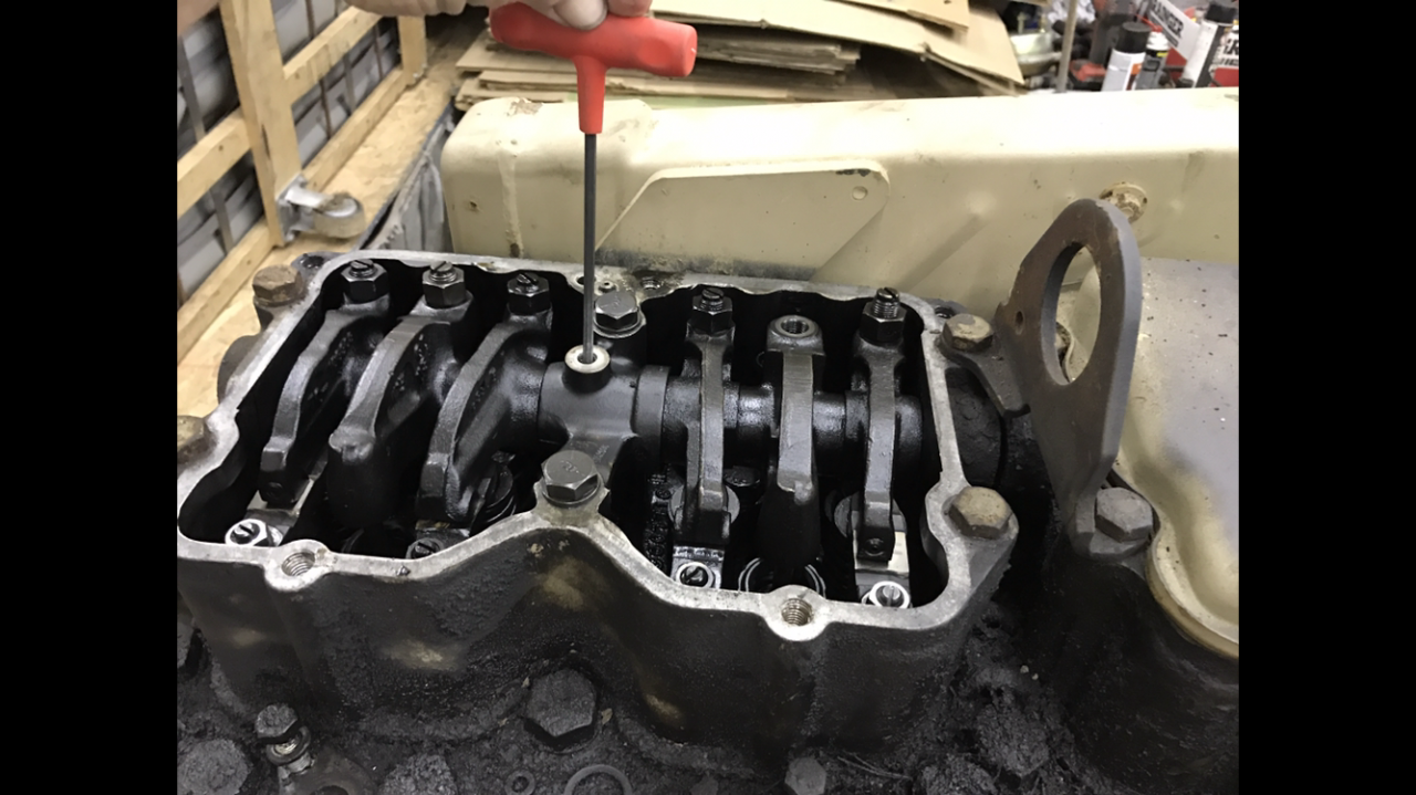

    Need the jakes that will work with your turbo. I’m running model 425A jakes with a HT60 from a 525 N14 Redtop.
    Make sure you open the oil feed galley in top of the rocker box “when adding” Jakes. Just a set screw but with Jakes it’s hollow.

    Notice I’m holding 2 set screws, one solid and one open through the middle for oil flow to the jakes.
    6C2A6BD6-F8B7-4CB0-A75E-2EF4C3761718.png E8766942-9699-4DA5-BA90-7AF3357C6070.png 908140CA-7435-4D49-9B7D-1E3F731EAEF3.png
    EverLuc and jamespmack Thank this.
