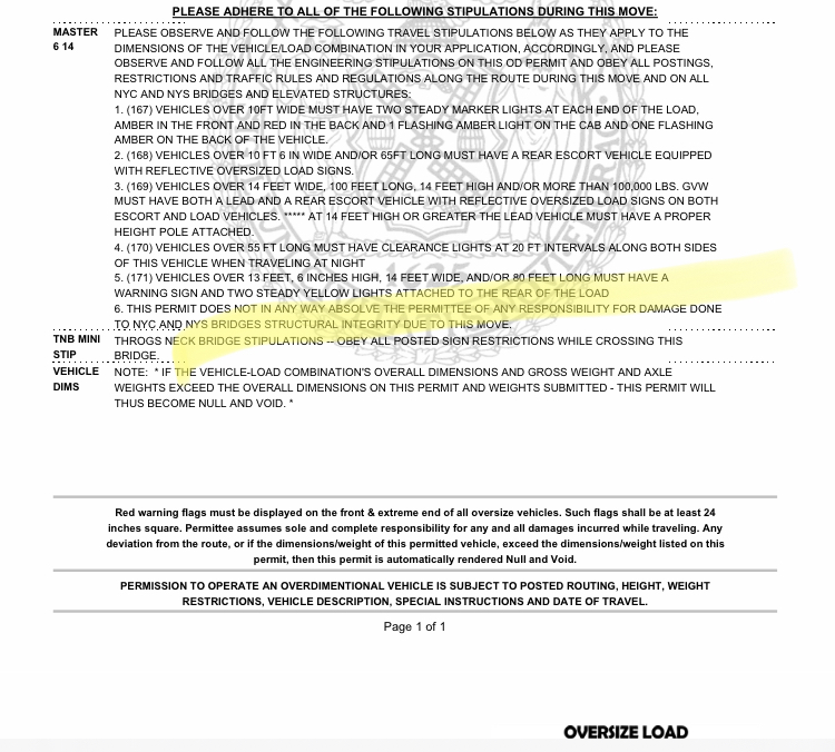

    If your holding a permit for over height and on the interstate, is that considered a safe bet? Many overpasses are not labeled.

    It “should” be safe but it always worries me. The state makes it clear (at least here) that even if your on your prescribed route and are within your permitted dimensions you’re still at fault.
  7. Ruthless
    Ruthless Road Train Member
    9,361
    93,818
    Aug 28, 2010
    The City.
    “if you do what we tell you and there’s a problem: it’s YOUR problem”
  8. Rontonio
    Rontonio Road Train Member
    6,549
    48,616
    Aug 9, 2009
    it is the same out here - pretty much everywhere I have run.
