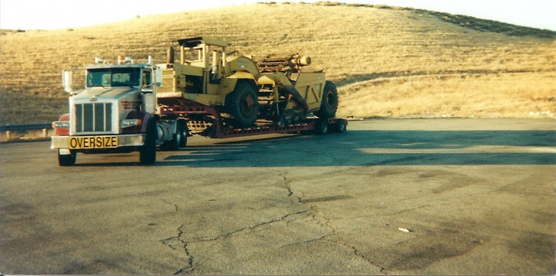

    631D-1.jpg 631D-L.jpg 631D-R.jpg Couple of 631Ds and a 345B

    What size well on that?

    24'. this trailer is an 84 model. 75 ton. the standard out here now is 28 I think
