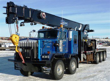

  6. So I'm assuming your talking units like uploadfromtaptalk1429589590952.jpg

    That truck will have it ^ but even my truck with 425 steer tires had it, even my 385 had dual steering boxes

  8. johndeere4020
    8,522
    119,296
    Jan 1, 2010
    No thats a twin steer, dual steering box set ups are for bigger capacity front ends I think around 17,000 and up. There is another steering box on the right side just like the left, except it has hoses running from the left box or "master" if you will instead of a steering input shaft. It has a pitman arm and drag link just like the left side, it's there to "assist" the main box when the front end is loaded heavy.
    Cetane+ Thanks this.

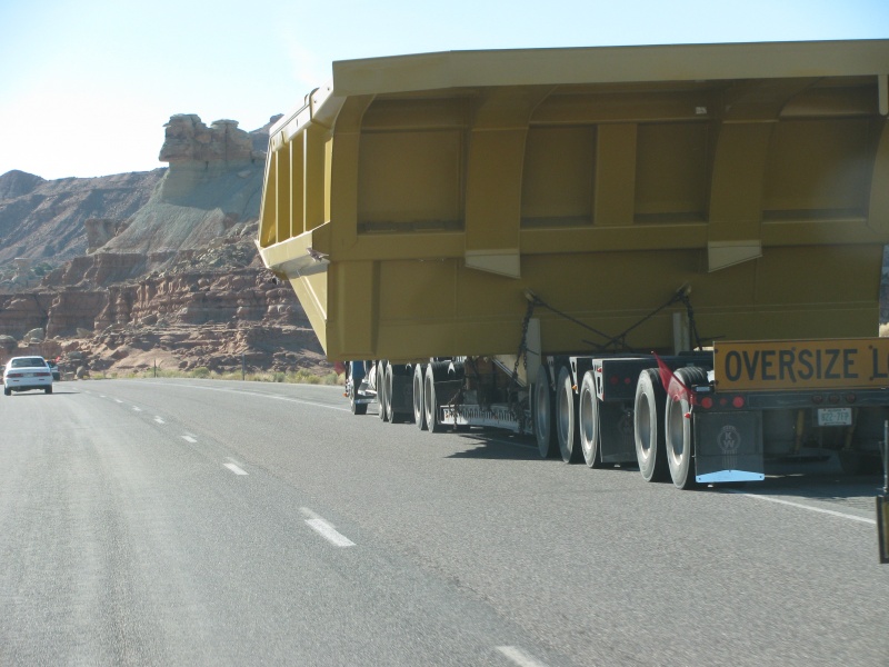

    dump bed2.jpg dump bed1.jpg Took these from my car in Oct. 2010 on W/B 70 in Utah. Anybody recognize the truck?
