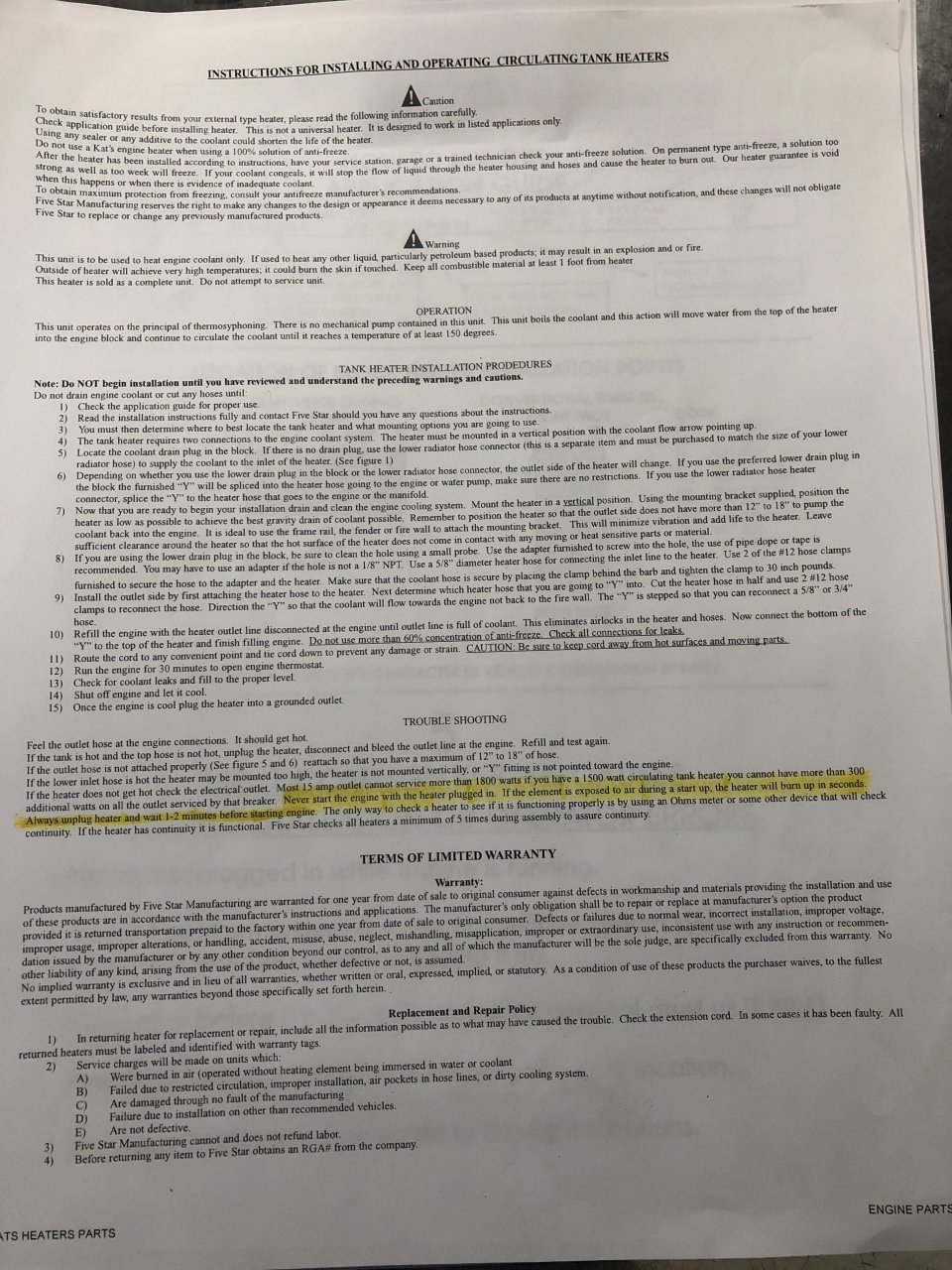

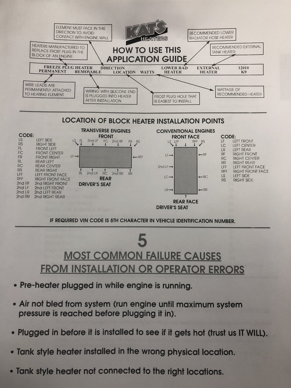

    Educated (thanks!), but unconvinced. Written by engineers, or product liability lawyers? (I've been involved in new product development). I agree that plugging in an uninstalled element is dumb, but I'm not buying the failure when installed in a properly filled, running, system.
    I will certainly consider the information, but I doubt I'll change my personal practice.

    Myself I'd like to know how it could be exposed to air or a void in the coolant? Its fully submerged in coolant in the engine. Only way I could see it being exposed to air is if the coolant leaked out from a cold leak. At that point you've got bigger problems if you're running the engine.
