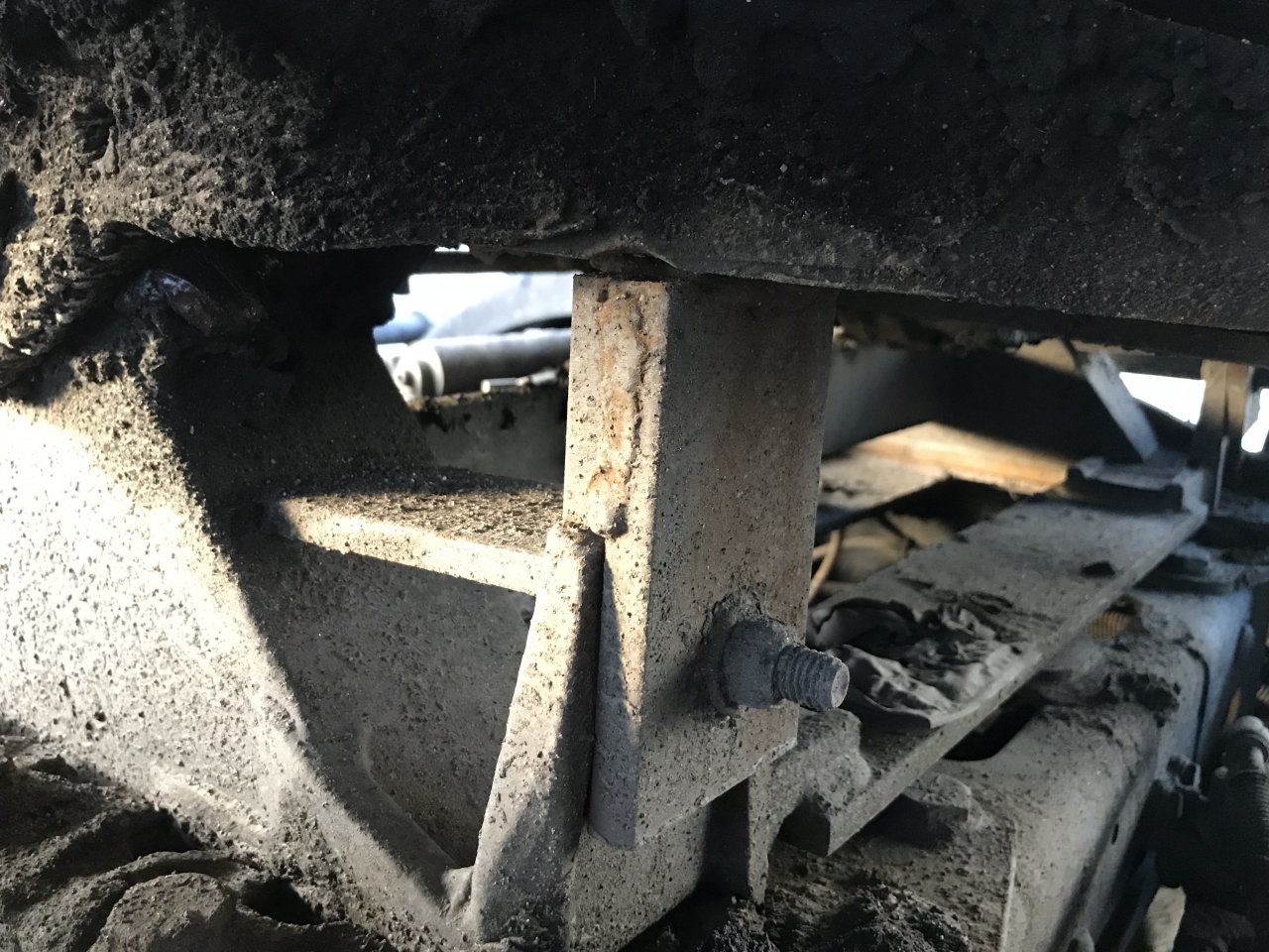

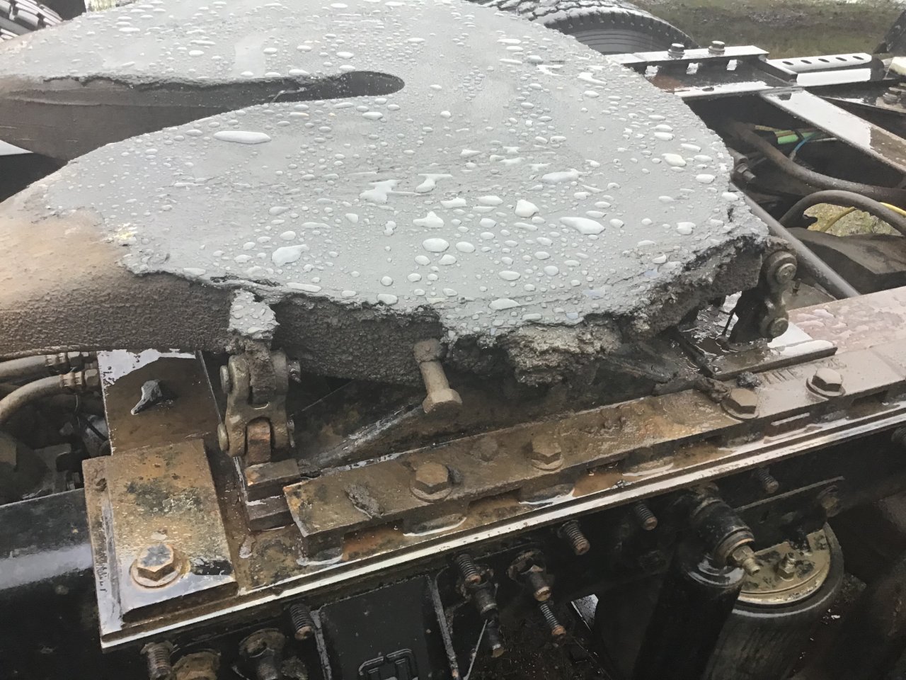

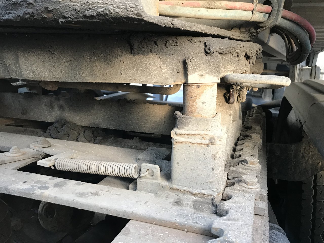

    Here's how page did mine. FC4C4862-A98B-47BF-B20E-B0CE383506AA.jpeg B02064FC-D0B9-431E-A007-1DBE2C14C3FB.jpeg A25B5FBD-D1F0-4A1F-B198-0012112FAAD0.jpeg
    Daycabinit Thanks this.
