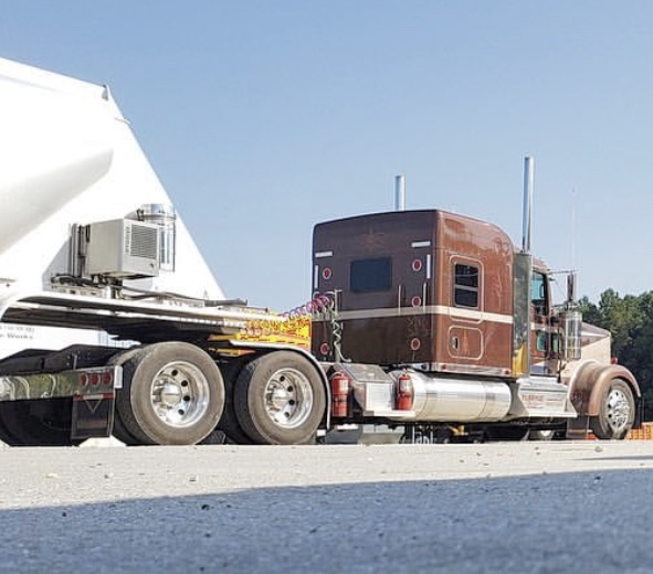

    A buddy of mine went to work for Fleenor. Most of their trucks have a pto/wet kit on them. Here’s the setup they have on the pneumatics they have. Pretty much any of their trucks can hook up to one and go to work.
