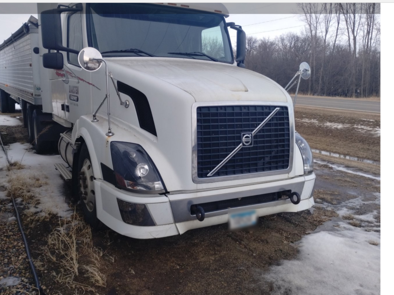

    Auction buy. 2004 Volvo D12 12 speed Meritor automatic transmission. *i think* price was dang good. Bunch of minor fixes, batteries, yes high mikes 960,000. But I am figuring 3000 miles a year.
    Got it legal but the automatic transmission confuses me. *only 250 miles so far*. ;)
    On start CL *or CH* and AL flash. After few minutes they go off. Starts in 3. Which normally is fine. But today going across worked field to line up under auger. It was fine in 3rd. But it decided to shift to 5th. Fine on tar. But field? By time it shifted twice I was stopped, tires just spin. Backing up constant worked great. If it had stayed in 3 no issue as empty. It’s supposed to have manual option. How do I access it? Any YouTube have control on steering wheel. Mine is control ahead of hip. Brake forward goes into 3. Right button is N. So Push function button *left button* pull back, pause 2 seconds? in R.
    Anyone know how to get manual shifting? If not how to temporarily lock it in 3rd?
    O am impressed by it. 4 loads. *ok overloads* of corn. Last two barely over 80k runs smooth. Motor electric fan started today scared me for half a second. ;) it wants to RUN loaded. But from stop. It does this dang double shift. 3,5,6,8, before I even complete a left turn. So REALLY slow left hand turns. As rural area not a big deal. But if I could manually button shift imo it would be much better.
    I have driven 10, 13, 18 speed manuals decades back. But left leg injury even shifting few times is uncomfortable. IMG_7718.png
