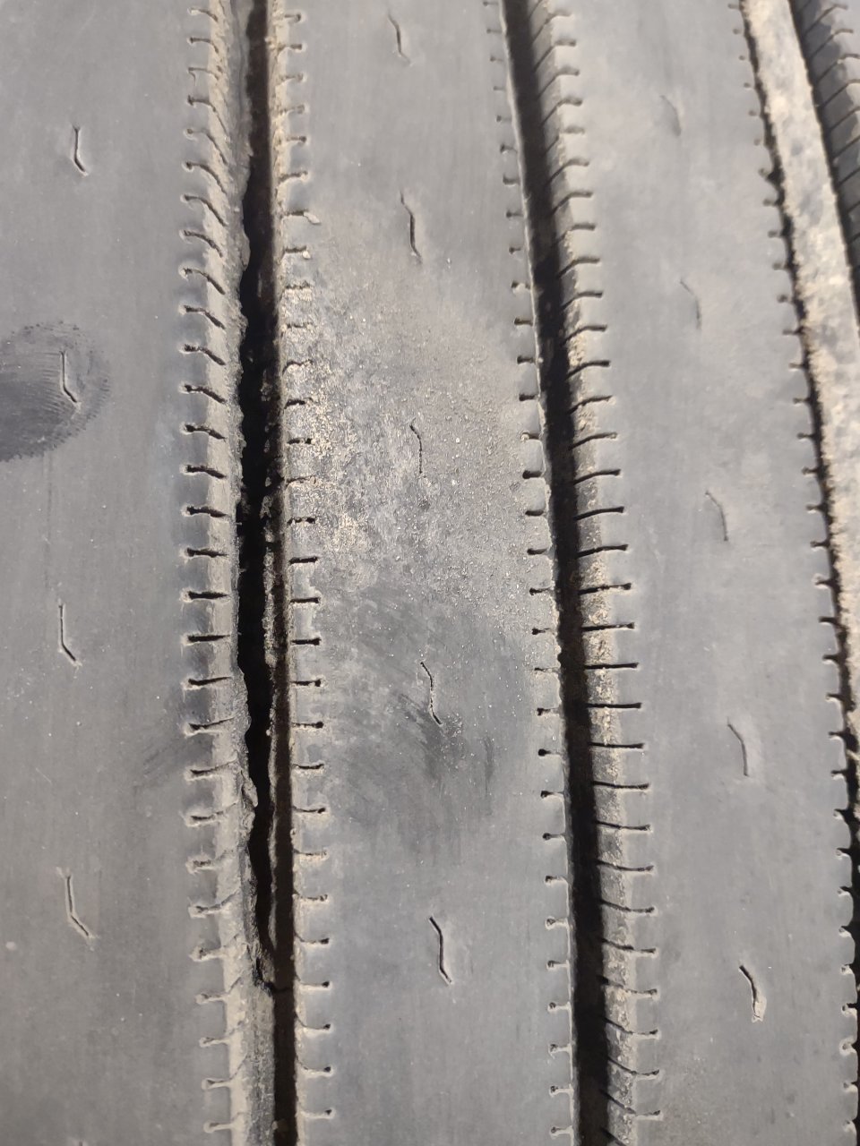

    I am hopeing maybe someone on here has had the same problem I am haveing I have had bouncing problem with my truck for a while comeing from my front axle I have already replaced leaf springs, bearings, shocks and wheels and new tires also drag link , ubolts, and u joints but my truck still bounces at times and am noticing that my driver side steer tire is finishing faster then my passenger side steer tire driver side is at 16/32 while passenger side is at 19/32 thinking it might be a king pin problem but had them checked and was told they were good no type of ply truck is a 2016 kenworth t680 if any one has any experience with similar issue your feed back would be appreciated.

  11. Bigtruckdrivah
    Bigtruckdrivah Light Load Member
    186
    224
    May 31, 2020
    If that’s a Goodyear steer, swap them out. I just chased the exact same issue. Had a bounce, just enough to make the hood wiggle at various speeds or weights. I put shocks, u bolts, 3 axle alignment, Centramatics, and finally just swapped the tires. That one in the pic, mine looked the same and it only got worse. After it was dismounted it was obviously a bad tire it was out of round bad. Sucks to replace steers with 18/32 left on them
