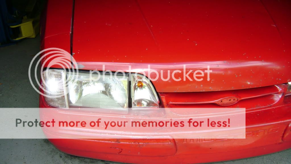

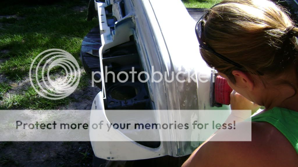

    I built this car for my son's 16th birthday.
    1990 Mustang LX. It had been around the block a few times. Motor had a bad knock. But the body was straight, rust free, interior was clean and not mangled. Would make a perfect project car.
    This is how it looked when I first brought it home. Paid $800 originally for the car.

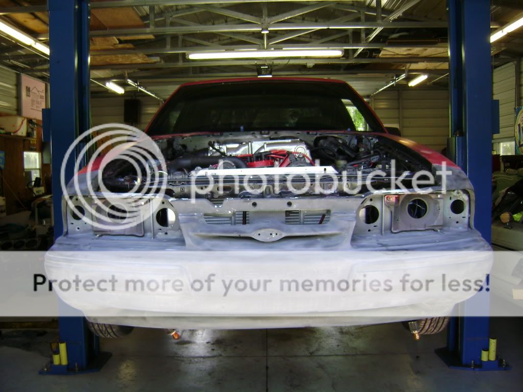

    This bought a straight nose to replace the boogered up one on it.
    My wife decided should would do the nose.
    My wife is full of many talants.
    Here I start tearing the car apart.

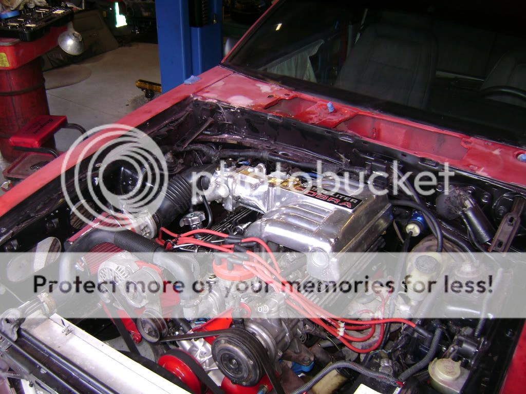

    The stock 5.0 had a wiped out cam, crank wasnt in much better shape, cylinder walls were toast. Bought a 5.0 from a 1997 Ford Explorer, they have GT40 heads stock. Proceeded to convert it for use in the Mustang.
    The stock motor had some decent 1.72 SVO rockers. I figured those with an F-303 cam, GT40 heads and Intake. Should make for a nice little screamer of a 302.
    This is the Explorer motor coming back together.
    My wife can not sit idle and watch,.. she is a very hands on person in all aspects of everything we do. We do it together.

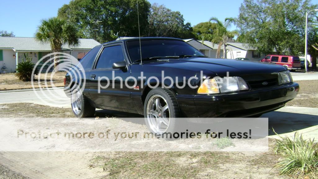

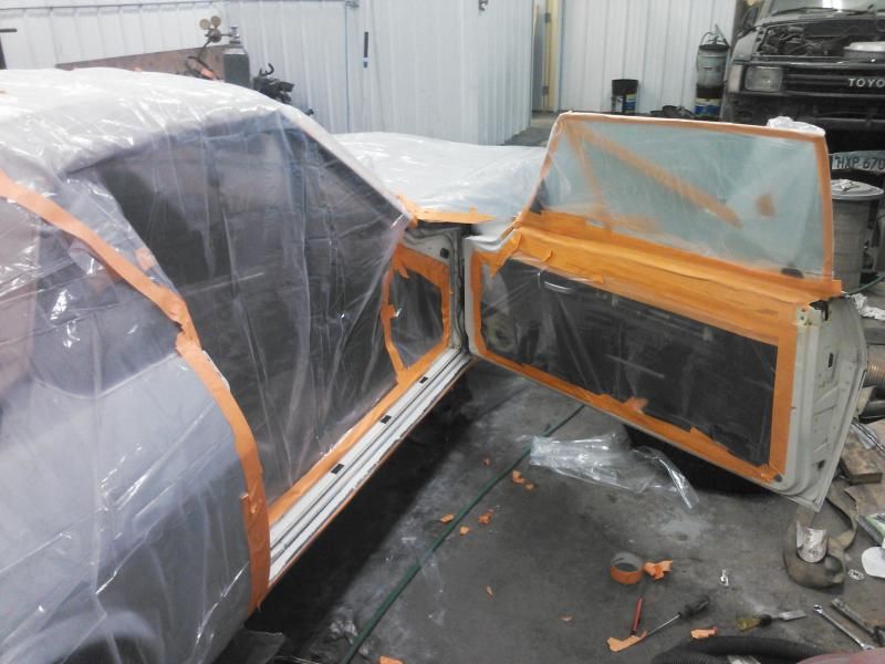

    The now sexy, cam loping 5.0 running good.
    Friend has a paint booth and let me use it. Son wanted black,.. I explained to him,.. enjoy it now,.. this is the last time it will look this good.

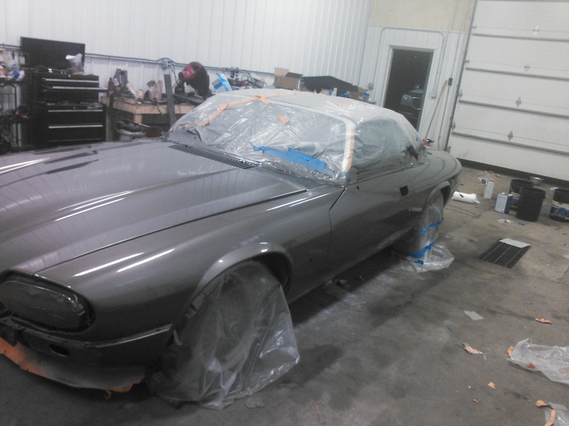

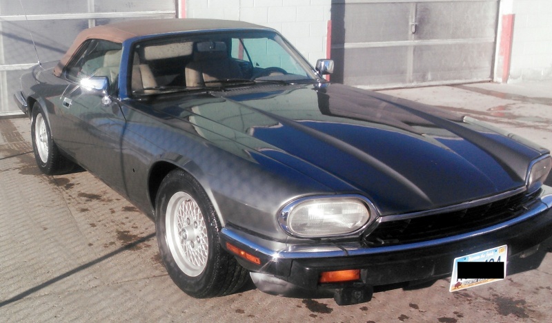

    seems like i shoot probably 2 cars every 3 years. I personally refuse to ever paint a car black. factory color on my jag was white. i bought it with a very very poorly done amateur black re-spray on it. i thought white was too plain and no way it was staying black. so i chose jaguar catkin pearl. but that meant cutting in all the jams ect. body was rust free and relatively straight no big dents but quite a few shopping cart type dings. so still took a while getting everything perfectly straight. high build primer blocked out then base clear and every paint job i have ever done gets cut and buffed because i have never had a booth to spray in so always get a certain amount of inclusion and such in the paint. but even shooting in a booth a cut and buff makes the difference between a ok paint job to a show quality paint job. it might look good after the paint lays but after a cut and buff you have a better than factory Finnish.
    id love to have a xke to play with but out of my price range. the xjs is still a surprisingly affordable car. paid $2250 for mine rust free good mechanical shape with kinda rough cosmetics. i like it because its a bit different not a car you see very often only and a very fun car to drive about 120k total cars made threw out the entire production run. the newer jags have no personality i would not want a newer one.
    i had a fox body mustang before as well. that was another great bang for the buck car, kinda ugly cars imo but respectfully quick stock some heads cam ect and you got a pretty hot car.
    when the woman got her current car she insisted that she wanted a black car, i tried to convince her otherwise we got her a 2-3 year old car that was black and looked pretty nice now that the car is 12 years old she says she will never have a black car ever again.
