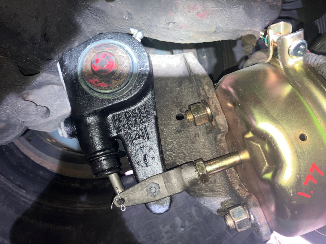

    I put 2 new combination chambers on the rear axle, they were 30-30 cut to fit. I had 2 different chambers on the truck, one really old odd ball looking one, and the other with a broken spring. So the length of the rod could not be copied over and was a pain in the ### trying to figure this out. So it was a start from scratch. Caged the chamber, installed, marked 90 degrees from s-cam center line and then measured back distance of clevis allowing thread full engagement. - It aint even close.
    Now assembled, adjusted correctly, when the parking brake is applied the angle is wrong, it is about an inch forward too far, past 90 degrees. Nowhere can I find any legal laws, rules, or anything written what is legally acceptable. I really dont want to take it all apart and redo it... it doesnt look bad, just not ideal and from what I read its not in spec.... but I cant find any legal specs. Is there even such a thing?

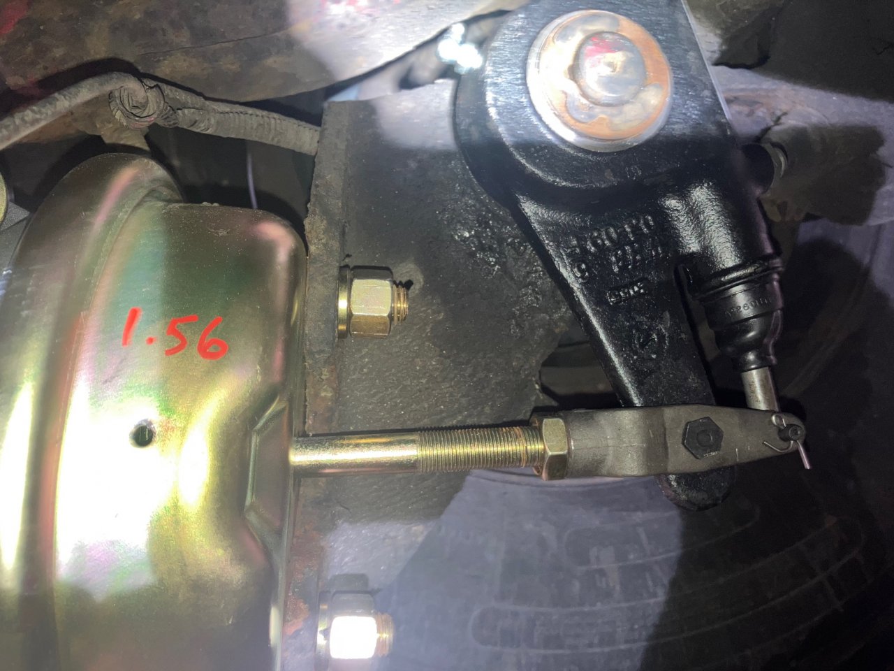

    All the vids even the manufacturer ones state for the "combination" chambers do them while they are caged. Thats wrong. I just squared them with the brakes applied. I cut another 1.75" off the rods. Top pic is how directions state to do it.... bottom one is corrected. Pretty stupid I dont know why you cant just buy ones made to fit..

    In the first pic it is obvious there is way too much rod and threads showing. If you had originally followed the method in the Bendix video you would have got it the first time, at least much closer than pic 1. Your pic 2 looks like what he ended up with in the video. Your method works and you ended up with the right result. However, there is nothing saying that the angle should be 90 degrees with the brakes applied or parking brake set. Selling the chambers with one length of rod and cutting allows one chamber to work for multiple applications. Kind of like universal. Universal is a bad word in my book and I always try to buy an exact fit to avoid modifications. Which is not possible with brake chambers.
