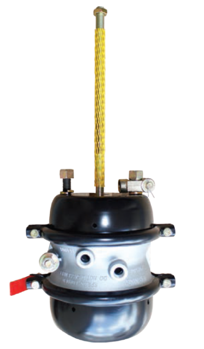

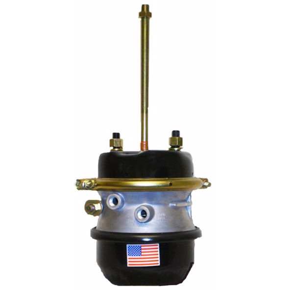

    True. Some trks only have maxis on 2 of the 4 brakes ( if its a tandem tractor).

    The clamp on the maxi is probably riveted, not bolted.

    Is there an easier way to get the brakes to release on a truck that won't run or a trailer that won't hold air?

    Why is one that you need to use a cut off wheel to service the proper one to buy?

    Yeah crimp the airline with vice grips, and back off the brake slack adjustment

    Why crimp the air line if there is no air pressure?

    I thought we were talking about leaking air chambers, They start leaking, and can’t over come the spring parking brake, and lose air, causing parking brake to set. Don’t know what you mean by no air? Air is leaking, till it’s so low, the brake starts dragging smoking. Hit the shoulder, pinch it off, back off shoes. Done it more than I’d like to remember.

    The post I had been quoted in when I said id caged off probably over a hundred on the farm and shop. With an electric impact it's a fast way to get a non running truck into or closer to the shop. Or to move a storage trailer out of the way.
