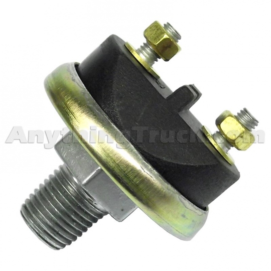

    It completes an electronic circuit, but do you think there might be a reason they’re installed on ports on the treadle valve?

    Air does in fact work the brake light switch. It's a normally open switch that when the pedal is depressed and air flows to the brake cans the pressure closes the switch thus turning on the brake lights
