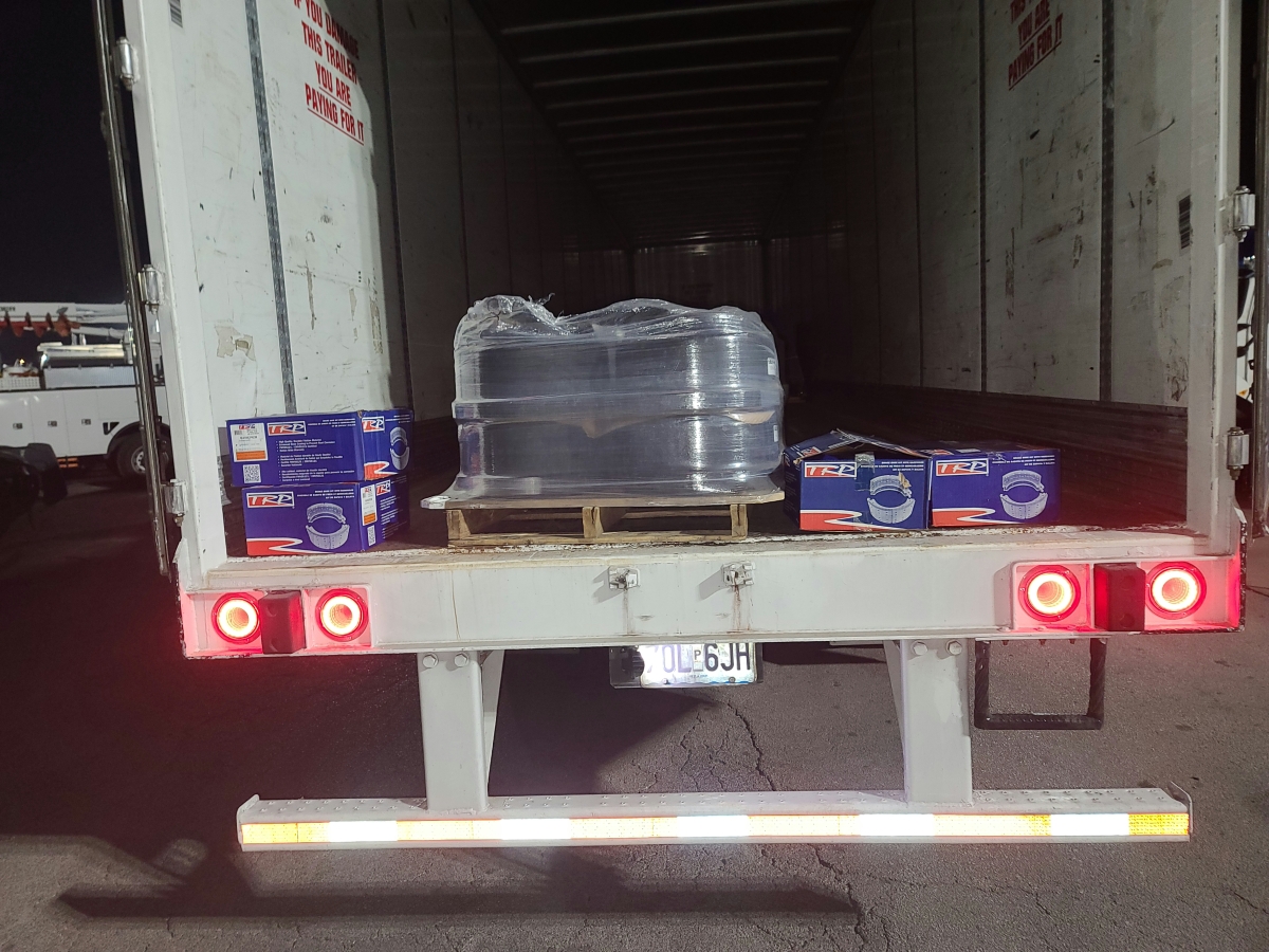

  11. Slow302
    Slow302 Medium Load Member
    348
    117
    Jul 12, 2013
    MO
    And new drive axle brakes and drums are on. Not bad for one afternoon on 95f Missouri weather grrrr
