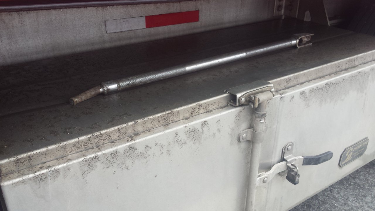

    I second alway placing the winch bar in the same place on the trailer. I normally do like @MJ1657 does. A couple weeks ago I didn't. I stopped 40 miles down the road to do my load check and my winch bar was not in my side box. It was here instead. Thank the trucker gods for air ride. 20170404_101916.jpg

    I do the same thing. Caught it in the mirror more than once.:rolleyes:
