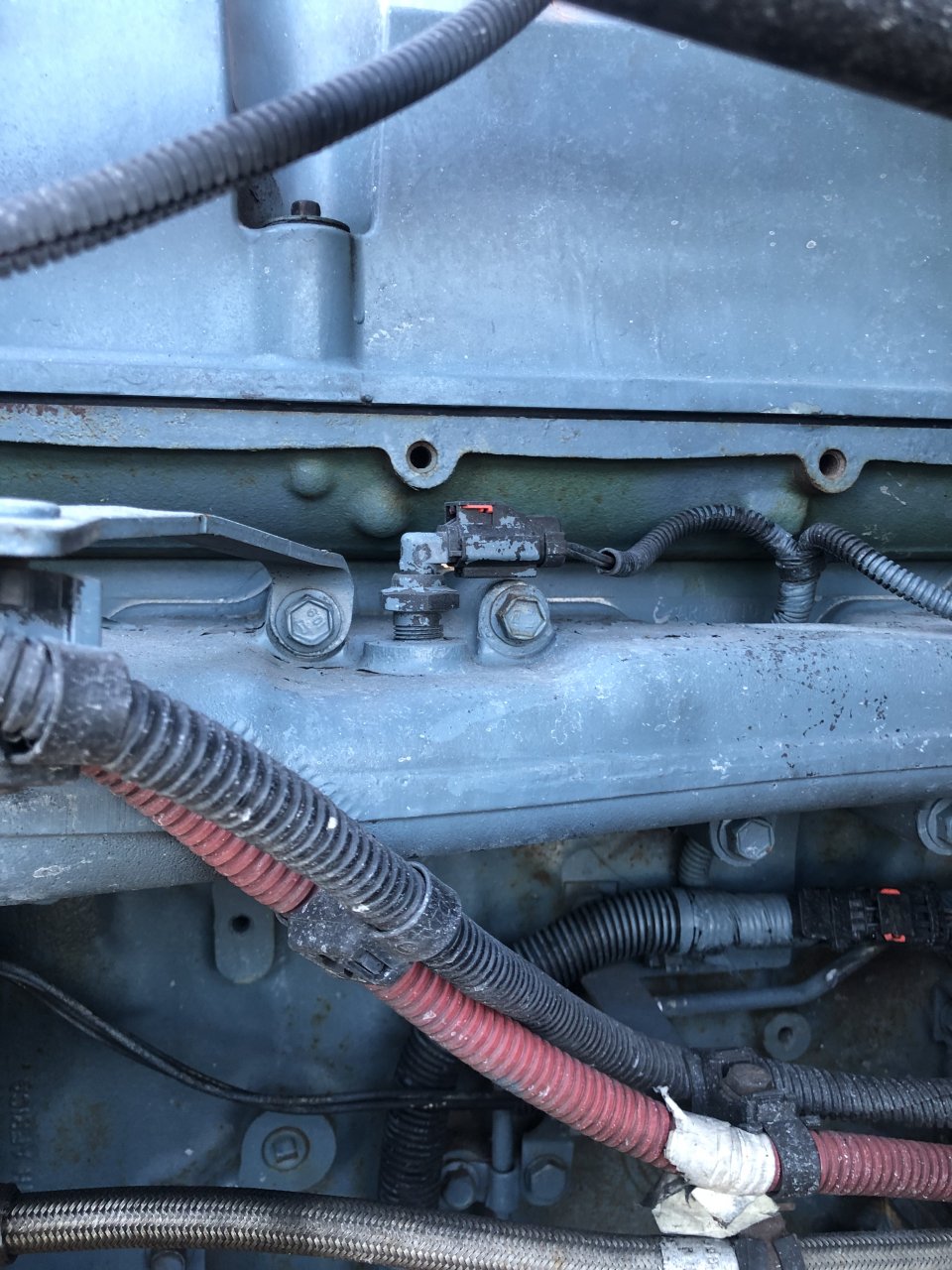

    Needs to be careful removing it. The bolts break easily. Need to spray well with pb blaster. I didn’t despite recommendations, Lol. The originals aren’t any grade at all.

    yeah now that you say this, I just remembered on my truck now, my turbo boost sensor has a broken bolt.... not hurting anything I guess.... its been like that for about 6 months now

    We got it out using a reverse drill bit. Still had a piece left deep in the manifold. Had to use a shorter bolt.

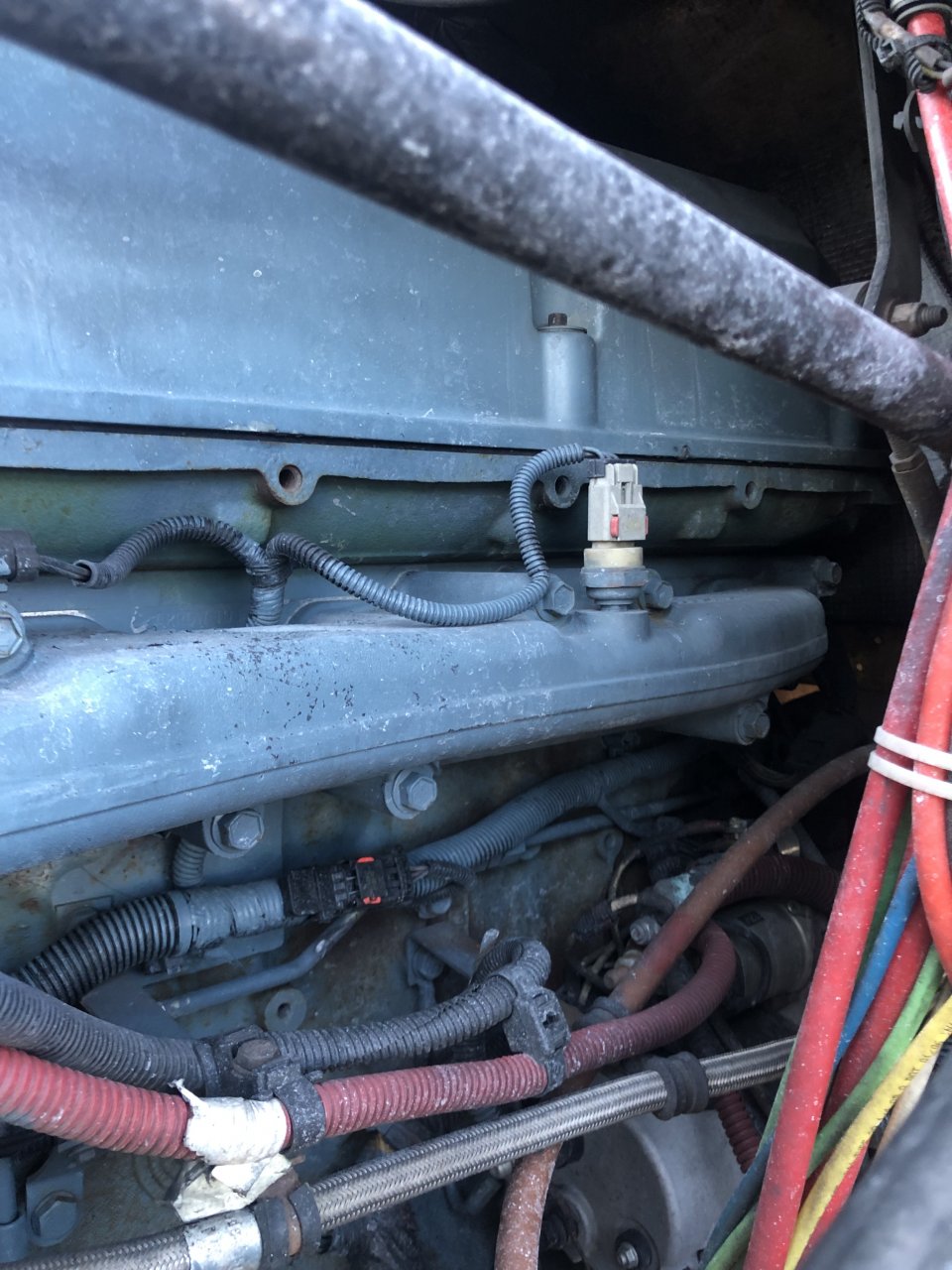

  5. Mcast3092
    Mcast3092 Light Load Member
    137
    107
    Jul 31, 2018
    Do you mean these two?
  6. nikmirbre
    nikmirbre Road Train Member
    5,589
    10,355
    Jul 27, 2011
    High Point NC
    9]8[8
    Yes I believe so. Refresh my memory( I haven't laid eyes on my truck in over a month......is there another sensor on the same area on other side of the engine?
  7. Mcast3092
    137
    107
    Jul 31, 2018
    Yes there is one similar to the L shaped on that goes into an elbow that is connected to the turbo
  8. nikmirbre
    5,589
    10,355
    Jul 27, 2011
    High Point NC
    ok never mind that one. Just the two on the manifold. Wish I had a part number for ya....

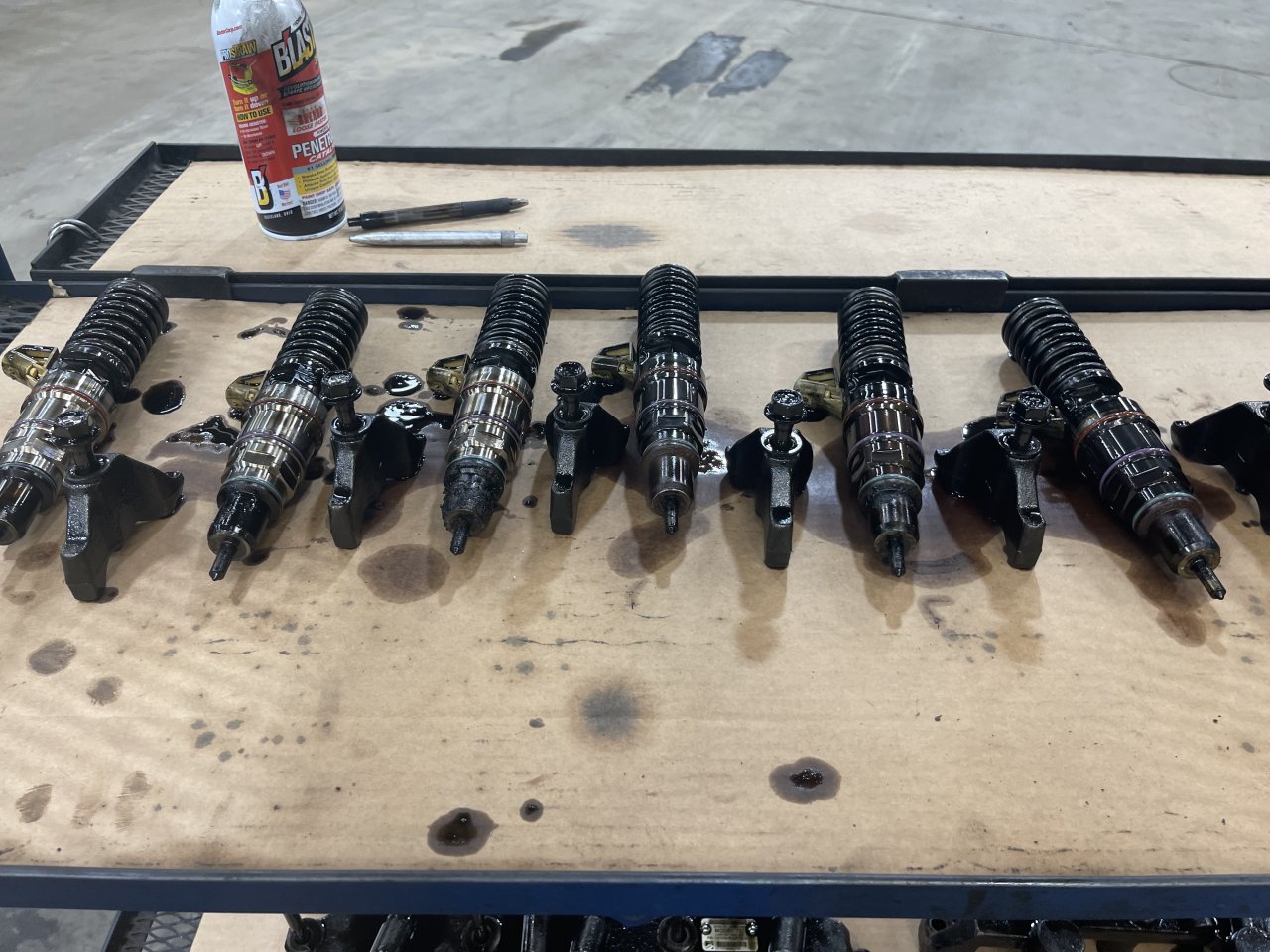

  10. Mcast3092
    137
    107
    Jul 31, 2018
    Si I changed the 2 sensors named above but still getting the check engine light at 1400 rpm’s when pulling a load. Any other suggestions?
  11. Mcast3092
    137
    107
    Jul 31, 2018
    Quick update, ended up taking my truck into the shop for my issue and turns out new injectors we needed. Here’s a pic
